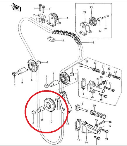

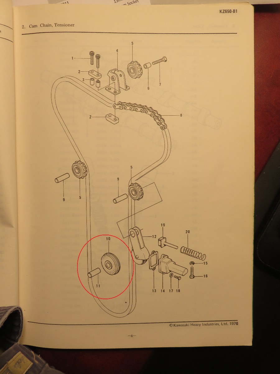

What dampers are you referring to? Ed
- Kiddynamite8
- Posts: 48
Re: Dropped dampers
10 Nov 2019 16:32
Thanks. Take a look at the cam chain guide roller shaft. If the ends of it are round it will not have rubber dampers (see 1st image below). If the ends of it have flats on it then it should have rubber dampers (see 2nd image below). Ed

Its ROUND! thank you so much ed! I LOVE you (in a friend way)!!!
I was losing my mind. Clymer steered me wrong today!
Thanks again ed!

The gasket keeps it in. The dampers are to lessen cam chain noise. I wonder why they didn't do that here. :huh:
Re: Dropped dampers
10 Nov 2019 18:57 - 10 Nov 2019 18:57SWest wrote: The gasket keeps it in. The dampers are to lessen cam chain noise. I wonder why they didn't do that here. :huh:
The early KZ650's had no dampers, but the later ones did. I guess someone at Kawasaki thought the dampers would help reduce the noise, but frankly I can't say I've ever heard mine (mine are the early no damper type). Of course my hearing is pretty bad, so maybe that's why I don't hear it.
