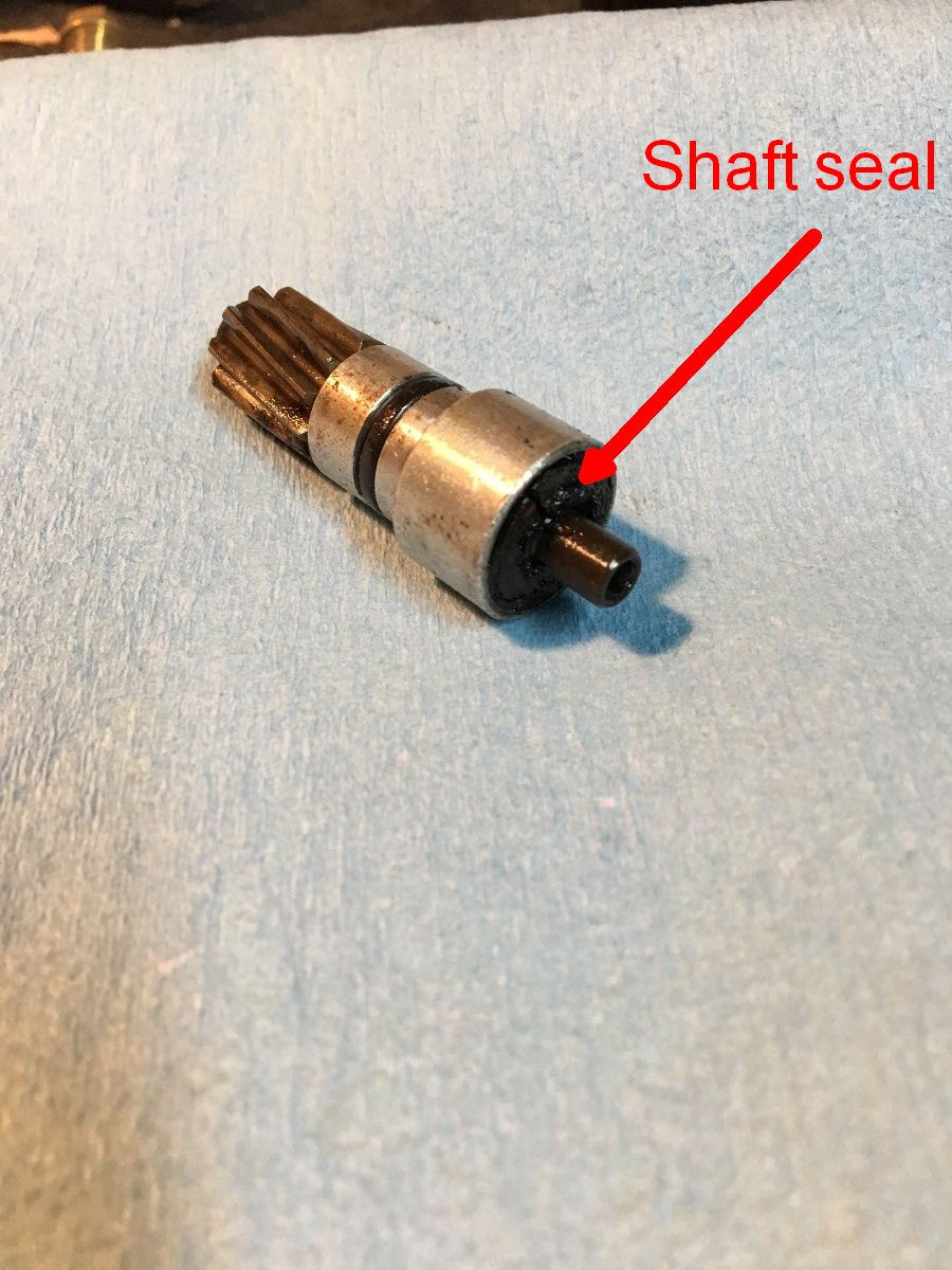

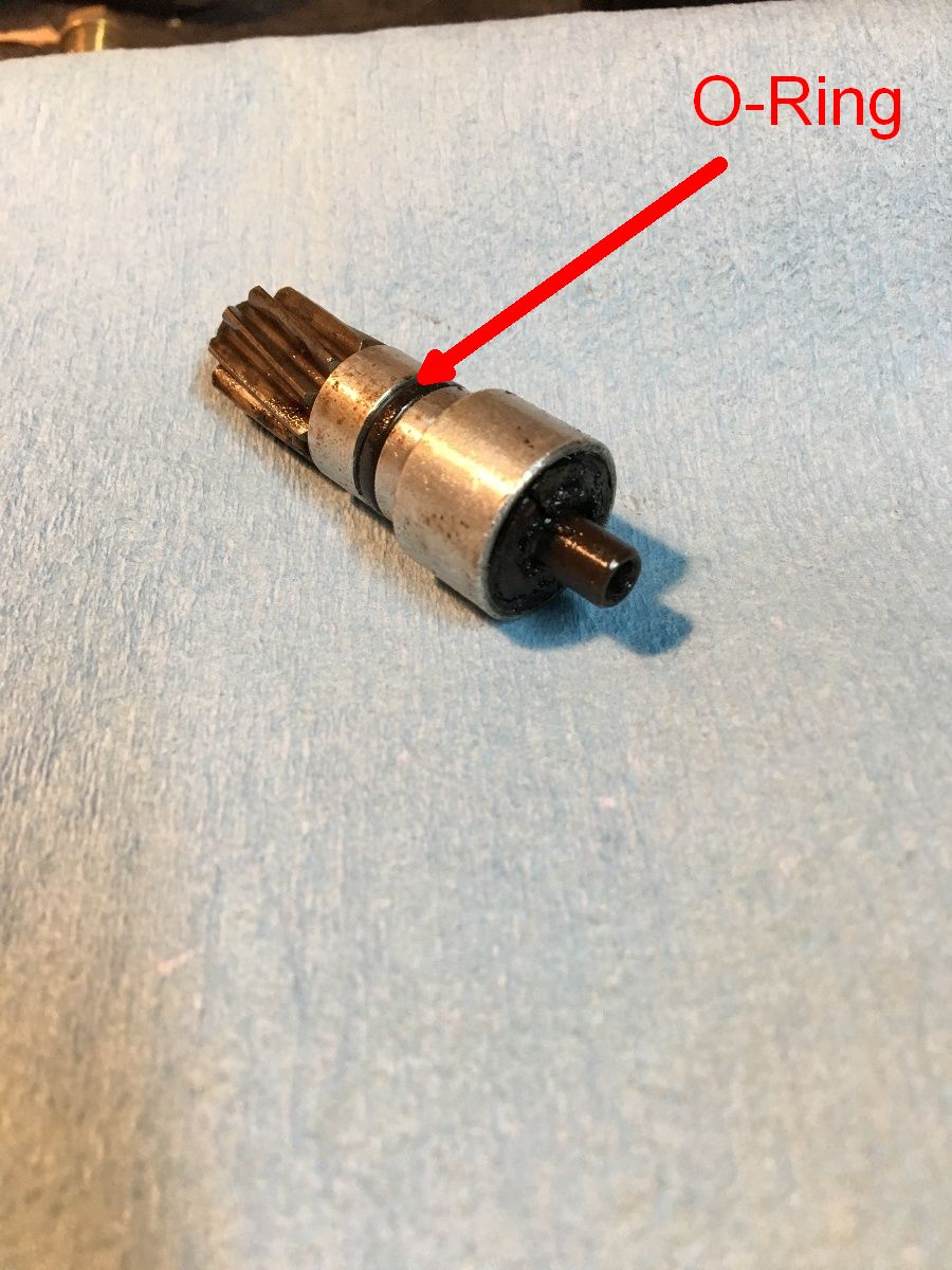

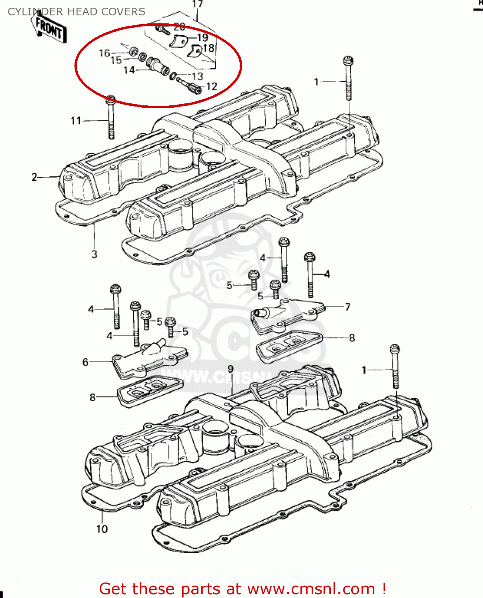

Could be the a leaking of the worm gear seal of the tach drive.
Here is a pic of an KZ750 twin worm gear drive.

Sorry for the late reply, so I pulled the tach cable and it is indeed a leaking seal, i bought new seals and rings and all, but now there is a new problem, the whole tach gear is stuck and i cant get it out, is there any way to get it out easily? Thanks

On my KZ1000, the drive was stuck as though welded to the head, and this was 30yrs ago. I could imagine and expect more stuck after years pass. I never got mine off, but had a missing flat paper gasket between the cable and drive that no one seems to even care of, but by replacing the paper gasket I had no more leak, so never removed the stuck on drive.

Plus 1 on the paper gasket, i have had a slight leak on all of my big Zeds at this point and made the gaskets on each one, leak cured every time.
