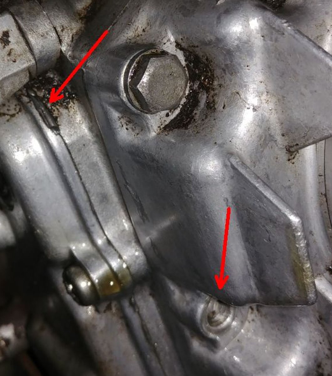

Ok gents, the last leak I have to trace is located on the bottom of the case. I only have a side stand and it's coming on the shifter side. I removed the head and there id's currently nowhere from up top where it can be coming from.
Here is the best pic I can get from under the bike. 78 kz650.
Thanks!

The clutch pushrod seal maybe. I'd pull the transmission cover off and replace all the seals.

Wow! Good call! I will see if I can get a whole new setup.
Thank you guys
