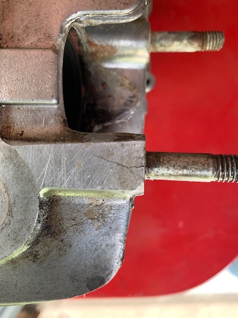

Finally received my head for my KZ-1000 back from APE yesterday. It looks like they did a very nice job, but I elected not to fix the crack in the exhaust stud boss while they had the head. The cost of the repair would have been quite expensive and there would have been no guarantee it wouldn't crack again. It was a real Catch 22 for me, fix it and put a ton of money into something that may go bad again or find a new old head and have it refurbished or have my head gone over and leave the crack alone and see what happens. With $80.00 into the head just shipping it to APE I thought the best bet was to leave the crack as is and repair the other issues with it. Hopefully I will try and avoid stressing the bolt that sits in the cracked boss too much and it will survive. I think in order to avoid turning the stud into the head too far I am going to put some permanent thread lock compound on it and leave it setup. Then I will just use due caution when torqueing down the exhaust manifold nuts on that #1 pipe.
