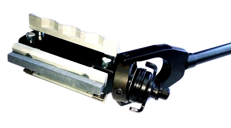

The proper way to finish up a freshly bored cylinder is to use something like the Sunnen adjustable hone. You start with a slightly undersize bored cylinder, and then you use the different grit stones to remove the herringbone pattern left on the cylinder wall from the boring bar as you open up the cylinder to the desired clearance. This style hone keeps the cylinder bore straight and round!!!
Those expandable three arm hones are worthless in trying to achieve a perfectly straight and round bore. You will NEVER see one of them in any shop that does any type of high performance work. Its an alley mechanic's tool. You use a ball hone to break the glaze on a used cylinder, not to finish off a freshly bored cylinder. You can use the Sunnen adjustable hone to remove the egg and or taper out of a worn cylinder. It might put you at the max spec for bore size, but at least your bore is straight and round!!!
Read up on the proper way to bore and finish off a freshly bored cylinder. There is TONS of information on the internet on the way to finish off a cylinder bore.
I would check my piston to wall clearance with a dial bore gauge, not with feeler gauges either.
I would also check the ring end gap in each cylinder. I don't trust anyone. That way you know for sure its right!!!
The Sunnen adjustable hone tool

Ok. I'll be taking it to a shop for the final cylinder hone then. I've been told that I want to leave about .001 left in the cylinder to be honed out. Does that sound correct?

Once I stopped doing my own boring and honing. I always had the same person do the boring as well as the honing!!!! I never seen that split between two different shops.
Who ever does the honing I would ask to see what they use to finish off cylinders. The big Sunnen honing machines are more for car blocks. Never seen one used on motorcycle cylinders. Most motorcycle cylinders I have seen are usually clamped down in a solvent tank and honed by hand in a vertical motion.
One or two thousands sounds about right. It might depend on the person doing the honing.
