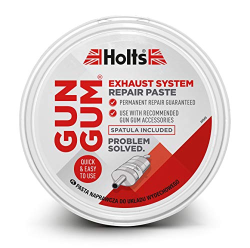

If you have a 4-into-1 system there will be one downpipe that crosses over the others to fit into the joining pipe. You need to 1) make sure it's properly seated all the way down into the joining pipe, and 2) use exhaust assembly paste (not the same stuff as exhaust repair paste). To make sure it's properly seated, feel and measure down the inside of the joining pipe, so that you know how far the downpipe is supposed to be seated. Then mark off that distance on the downpipe, and use a rubber mallet to knock the downpipe right into the joining section, making sure it goes in all the way.

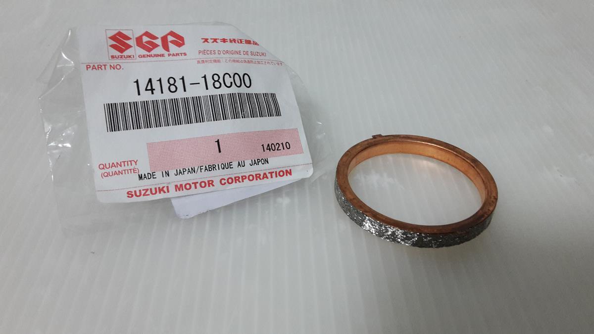

The OP says that the leak is in the crossover pipe, not where the pipe meets the head.
I think he needs two of these.
www.partzilla.com/product/kawasaki/11060...bdfebb454b102ae5dc92

What I linked to was for the 1983 KZ440, since there was no KZ400 sold in the U.S. at that time. I went back and looked at the 1978 KZ400 parts diagram, and it does not show any gaskets for the crossover pipe on that model, so I dunno.
