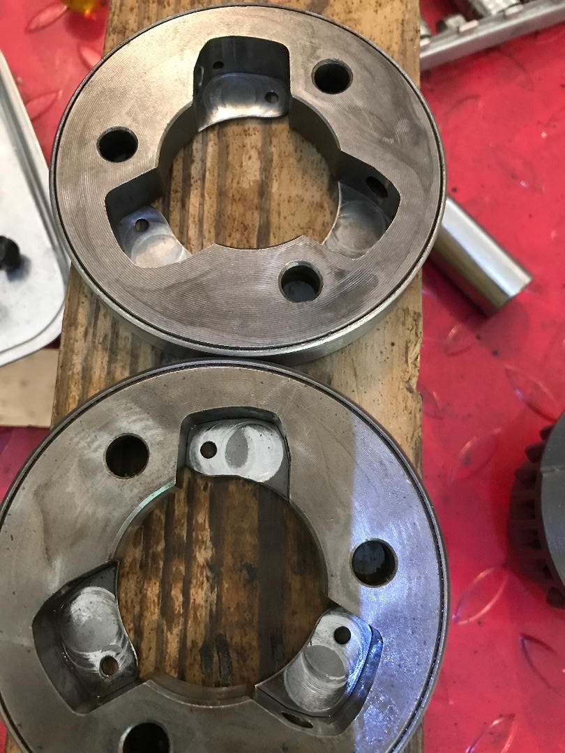

Hey guys....I'm replacing the starter clutch on my 1981 KZ750 , the previous owner gave me some spare parts among them wrapped up in paper was a starter clutch which I was going to use although It looked as though It had be used before but looks to be In good condition along with the springs the sleeves and the round discs , so after putting the starter clutch together something didn't seem right after looking at It for five minuets I saw the difference the " new used " plate was the opposite of the original WTF . So Is the "new used" one of a different bike or were they changed somewhere down the production line ?
In the pic the bottom one Is the original . Kicker Is there docent seem to be a lot wrong withe the one I am going to replace .

Looks like your "new old" starter clutch is out of an KZ750 twin engine. All Kawasaki twin engines cranks are rotating counter clockwise and four cylinder engines clockwise.
