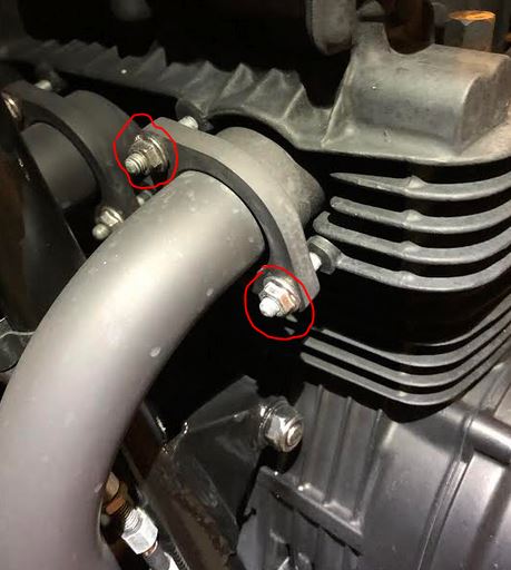

My nuts on the exhaust is unscrew because of vibration... What is th best I can do, instal some lock washer or something?
Pleae see attached photo.

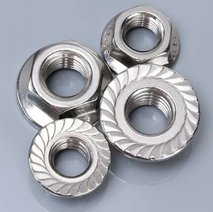

Can I use something like these ?

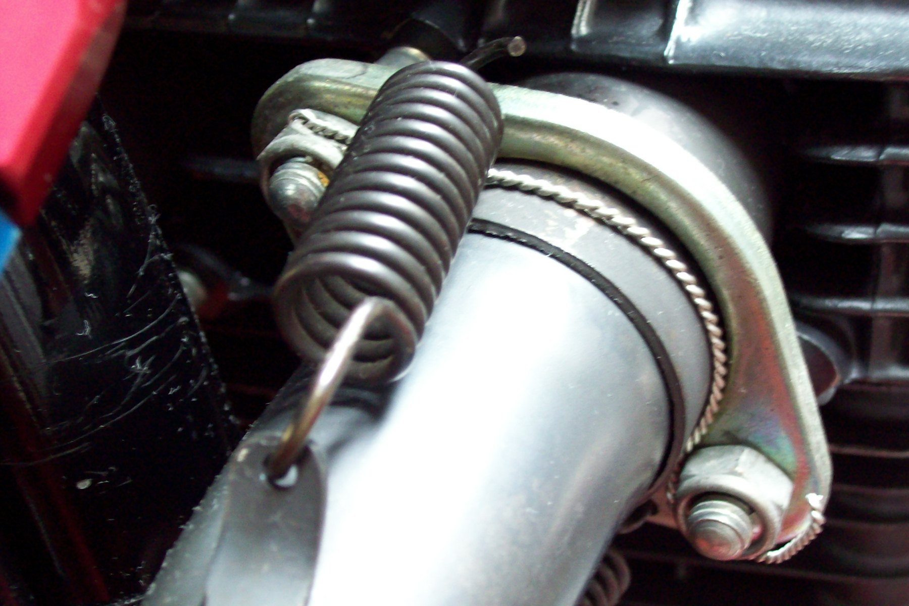

Safety wire them. Then you can just forget about them ever coming loose again!!!!
Unlike Loctite, when you go to remove them. The chance of the studs coming out with the nuts is zero!!!!

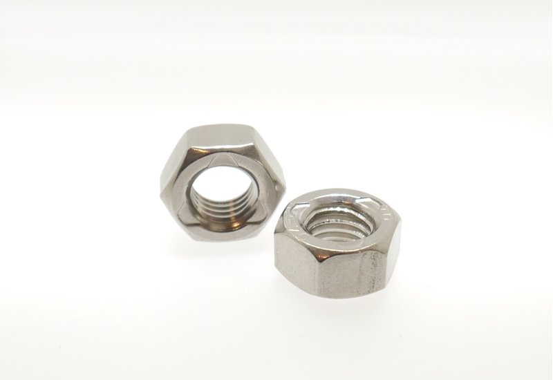

It looks like there are also Fuji, Fujilok U-nuts being used.
www.belmetric.com/metric-fuji-nuts-c-3_2...hk8p5d8s7903psg8o083
Hmm, I might have to get me some too.

02 Oct 2019 13:28 - 02 Oct 2019 13:35loudhvx wrote: It looks like there are also Fuji, Fujilok U-nuts being used.
I have problem to find Metric Fuji Nuts in A4... ?
I want the nut to looks good in many years... maybe A4 don`t exsist, Zinc good also ?

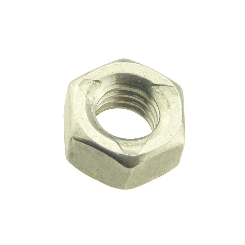

These looks good !
Hem... I have problem to locate same type on ebay, can they be called something else also?
Closet I have found is called Binx Nuts:
These looks good !

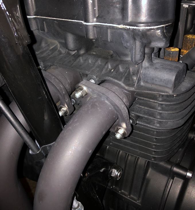

No eBay APP ID and/or Cert ID defined in Kunena configurationAre you using the fasteners in your 1st pic? The stock exhaust holder nuts are flat where they contact the exhaust holders. not serrated like the ones in the pic. Also, when tightening the nuts, I do them gradually & in sequence. similar to tightening the valve cover bolts.
For some fasteners I use Permatex high temp thread sealant as a thread locker. I believe it's the same stuff used on pipe fittings by plumbers. It sets up as a thick paste, but you can reposition the nuts afterwards. I sometimes use it when the manual doesn't specify a locking agent, but want to make certain the fastener stays in place. such as the Fr brake rotor bolts & a couple of other fasteners. The thread sealant may affect how you torque a bolt, so you have to be wary on something like the exhaust holder nuts.
