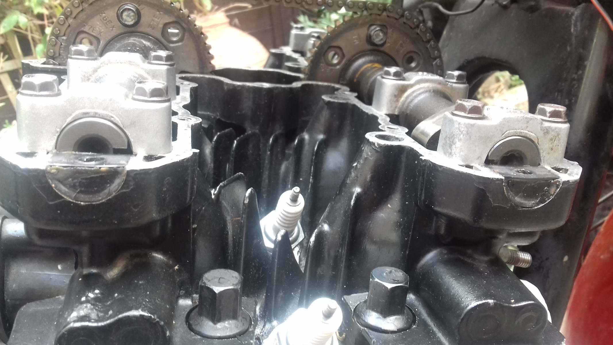

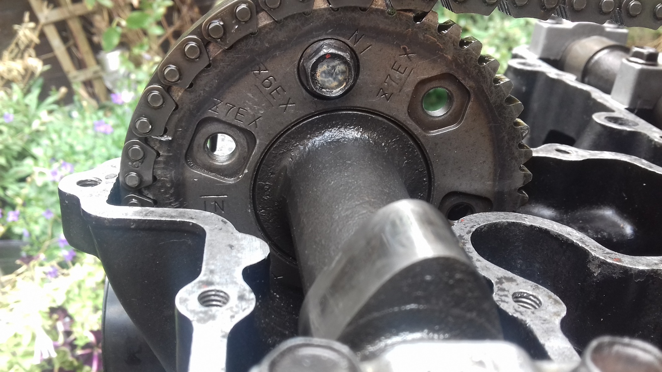

There was someone here a few years ago had a bike and the camshaft(s) were attached to the sprockets using the wrong bolt holes.
See pic below from the Kawasaki manual
Probably a long shot but should be easy the check if you have the valve cover off

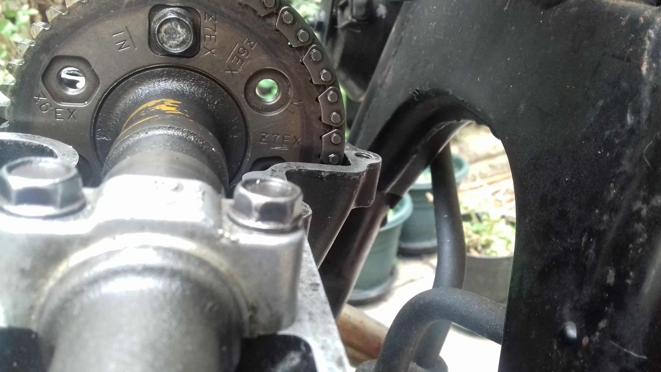

Spot on, I'd say, even though the camchain is slackened off. Even the notches in the cams line up.

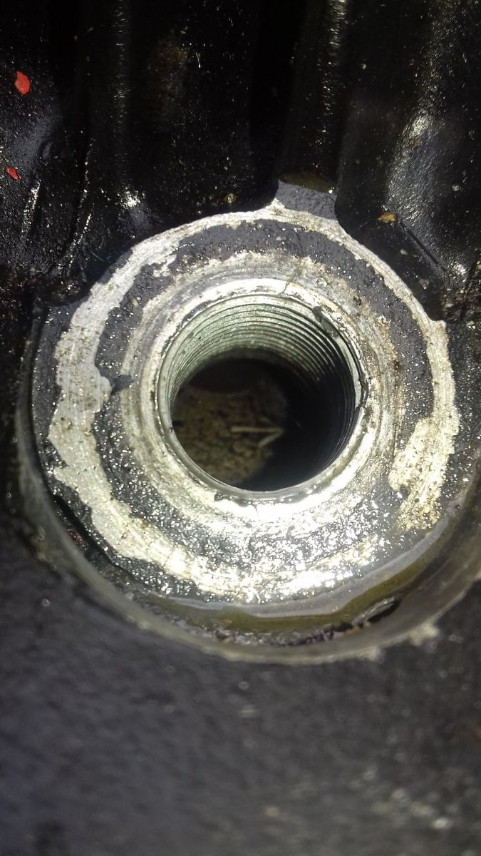

WHAT IS THAT CRACK AROUND THE SPARK PLUG LAND?

Pretty sure the intake cam should not line up as in your picture, just the exhaust. There are supposed to be a certain number of links between the marks instead (can’t recall off the top of my head). This is because with the cam cover off the rub block is not pushing down the chain. From the looks of the picture you are not factoring in the cam cover. Perhaps this is the issue?
