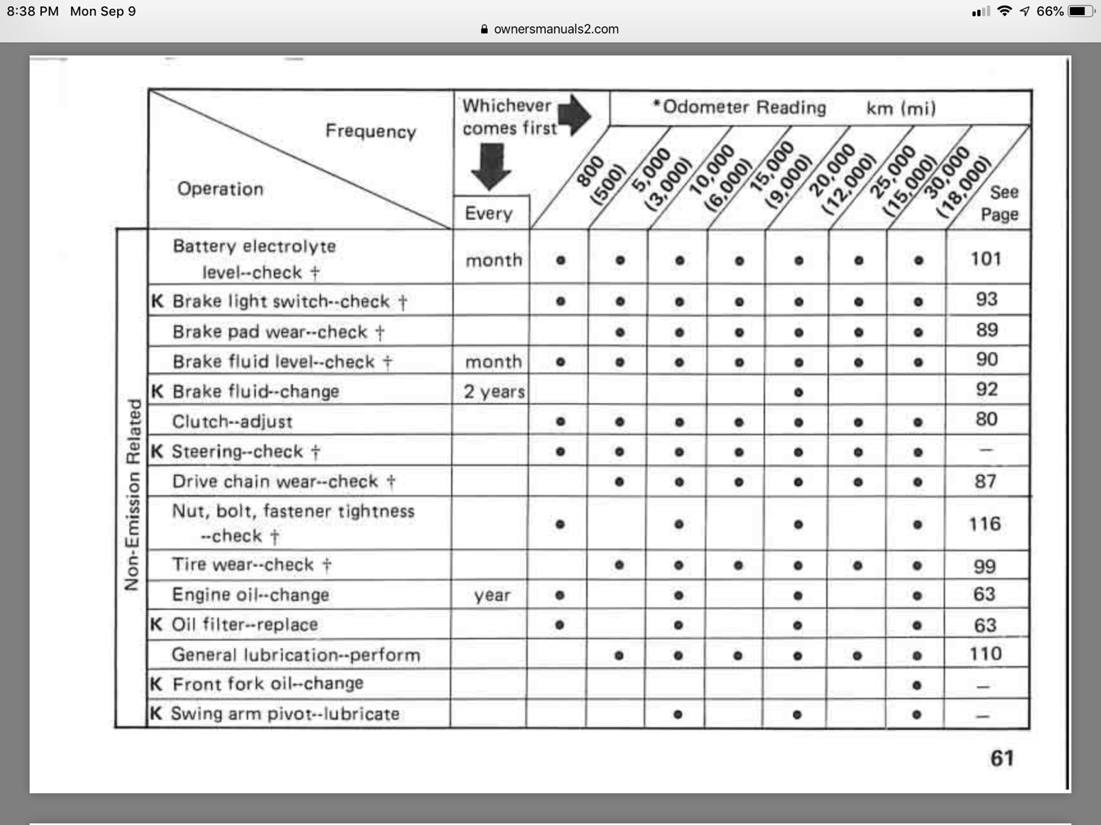

That’s what the owners manual for my 1990 zr550 recommends. I’ve been changing oil every 3K miles, but now I’m wondering if that’s overkill. Then again, I do thrash the poor thing pretty regularly...

Kawasaki recommends an oil change interval of 6,000 km (3,728.4 miles) for my water cooled 2000 ZRX1100. It does have a three-piece oil control ring and tighter tolerances than your typical air-cooled four banger.
What I also find interesting is that if I follow the oil change intervals in the fsm on the miles listed rather than the km, the oil change interval varies from 3,000 to 5,000 miles.
