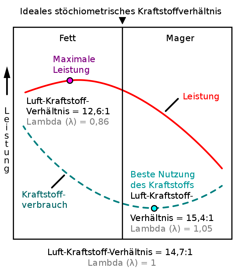

Engine is running too lean . O2 value should be 0,3-0,4 % vol. / Lambda 1,0

The CO/CO2 value is not the same as O2.
