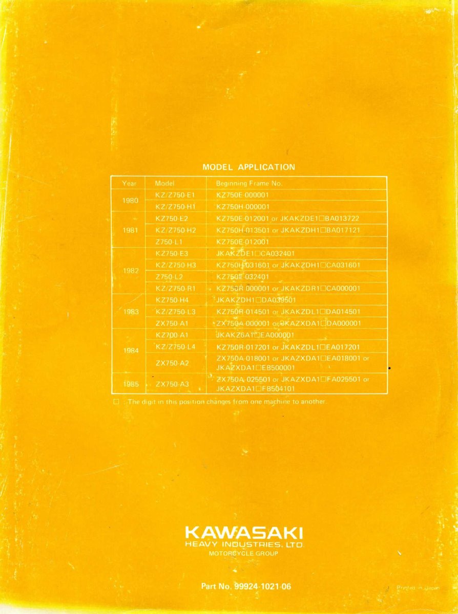

Hello and welcome to the Forum Mac55.
First at all, throw it away your Clymer and get a real Kawasaki manual.
www.750turbo.com/manuals/GPz750_Base%20Manual.pdf
