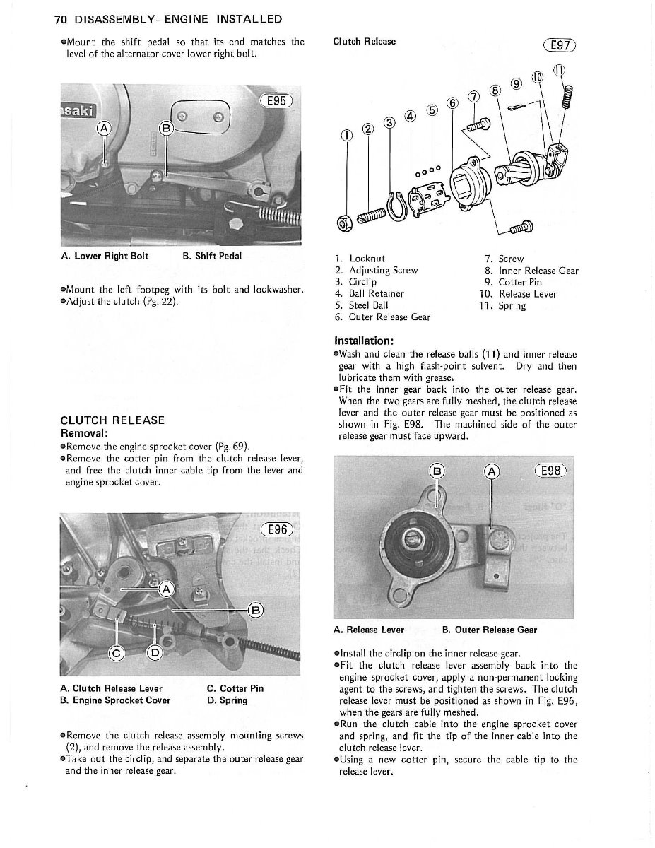

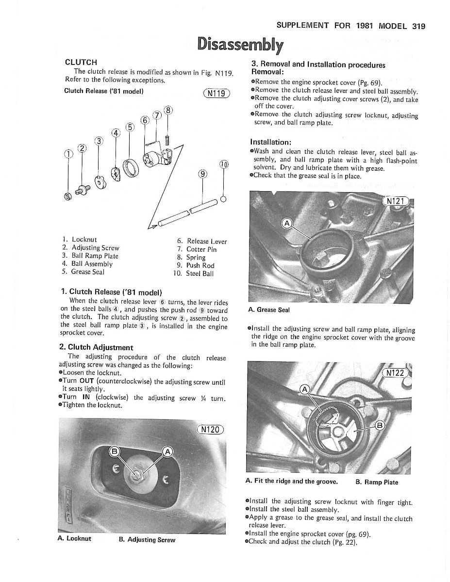

I don't know what the problem is, but just in case. when doing the clutch adjustment on the 550, I think you're supposed to turn the clutch release adjusting screw counterclockwise first until hard to turn, then clockwise 1/4 turn. It's kind of counter-intuitive. Some manuals don't specify the direction.
My 81 KZ650-CSR is counterclockwise first as noted in the owner's manual & factory service manual. Also, there should be a cotter pin that helps to keep the cable end seated in the engine/sprocket cover. Without the cotter pin, if you don't maintain cable tension when re-installing the sprocket cover, the cable end can become unseated. I install a new ss 1/16 x1-1/4" cotter pin from the hardware store each time.

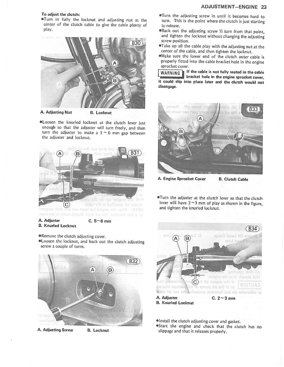

I think youre right on the adjuster. My book says in till and back out 1/2 a turn. Also my book doest say anything about how cable should stay in cover. Im gonna work on it this morning. Hopefully these two things are my problems.

Hi , speaking of lubricating the cable, don't forget to do the clutch cable pivot point. Photo B31 is a great picture of the cable end in the lever. Where the barrel of the cable rotates inside the lever. As long as the barrel can rotate properly, the chance of the cable breaking at the end is prevented. With that being said, this area is open for dirt to enter so keeping it clean is important as well. File any sharp edges too.
( Don't ask me how I know, and what a pain in the ass it was getting home...)

Yeah those two things are golden. Everything seems to be great now. Once i adjusted it the opposite way..went out then in. Its been great. I appreciate everyones help. I haven't owned a bike in 10 years. It wasnt running when i bought it so still trying to get the feel of it.
