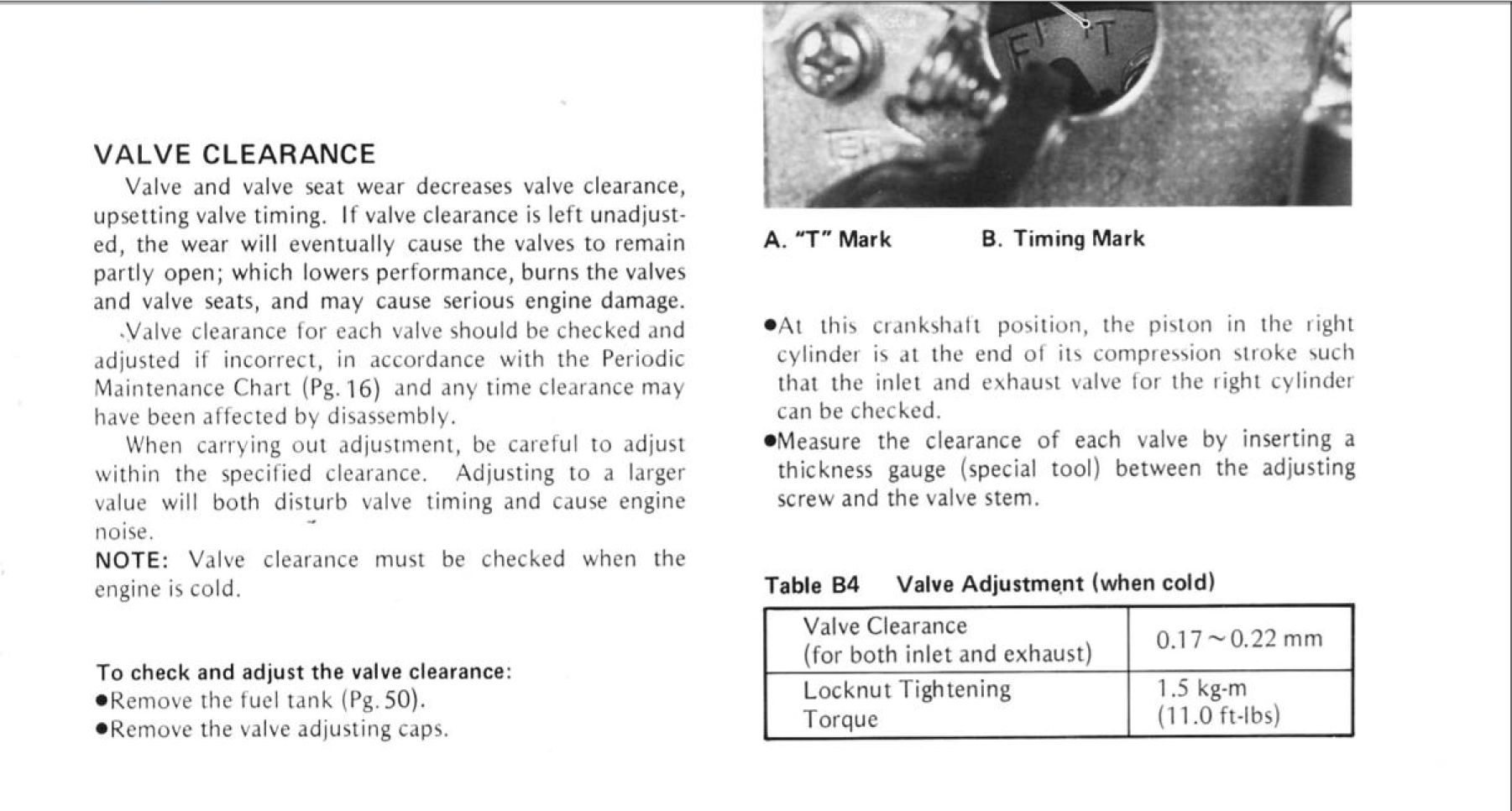

25 Jul 2019 12:13 - 25 Jul 2019 12:20Grcko wrote:
I then checked the valve lash (@.020
Are you sure about your valve clearence??? 0,020 mm is really tight. The valve lash should be 0,170 - 0,220 mm.
Last edit: 25 Jul 2019 12:20 by Scirocco.
- Grcko
- Posts: 168
- Thanks: 32
Re: 1983 kz440 LTD Only Firing On One Cylider
25 Jul 2019 13:16
Typo It is 0.20 mm Right in the middle of specs.
