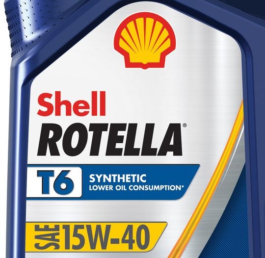

Good info and thank you all! I'll be switching it this weekend to Rotella T6 15w40 synthetic. It states on the bottle it is JASO-MA

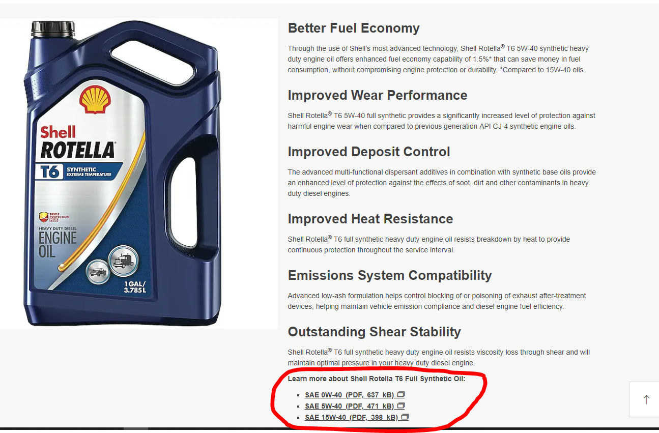

23 Jul 2019 16:33Serpent7 wrote: Good info and thank you all! I'll be switching it this weekend to Rotella T6 15w40 synthetic. It states on the bottle it is JASO-MA
The 5W-40 is synthetic. 15W-40 is mineral oil. Both good.

Re: Mobil 1, 10W40 tryout?
23 Jul 2019 18:41Nessism wrote:Serpent7 wrote: Good info and thank you all! I'll be switching it this weekend to Rotella T6 15w40 synthetic. It states on the bottle it is JASO-MA
The Rotella T6 15w-40 is synthetic. Ed
23 Jul 2019 18:43 - 23 Jul 2019 18:52650ed wrote: The Rotella T6 15w-40 is synthetic. Ed
Hum, I stand corrected. That must be new for this year.

I may try the 5w-40 then in Synthetic! thanks fellas!

UPDATE: I purchased Rotella 5w-40 full synthetic and will be installing it tonight!
