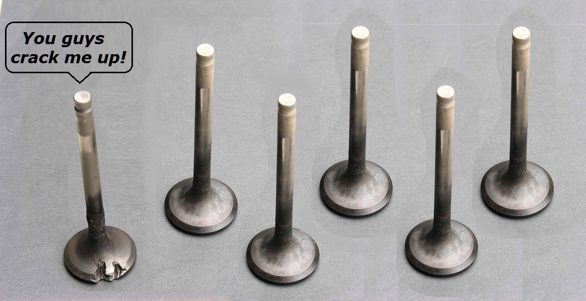

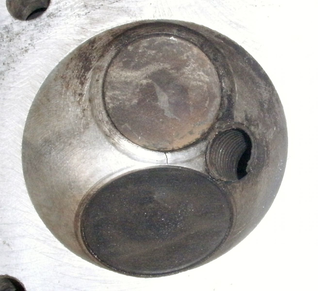

Patton wrote: Backfire through carb is likely due to an intake valve failing to fully seal when supposedly closed.
Could result from such conditions as insufficient clearance, burnt or broken valve, or damaged valve seat.
Some of the combustion inside the cylinder escapes past the supposedly closed intake valve and shoots back through the intake port and on through the carb.
Hopefully, the mating surfaces between the valve and seat are undamaged and will again provide complete seal when closed, given proper clearance required to enable closure when seated.
Continued operation with insufficient clearance is one reason for burnt valve faces and valve seats.
