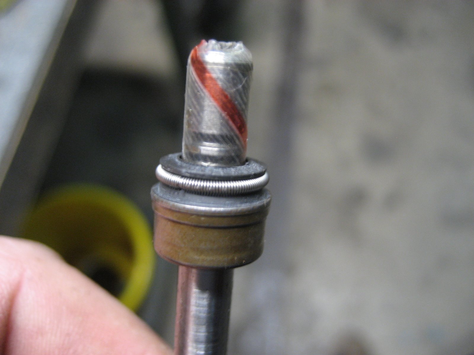

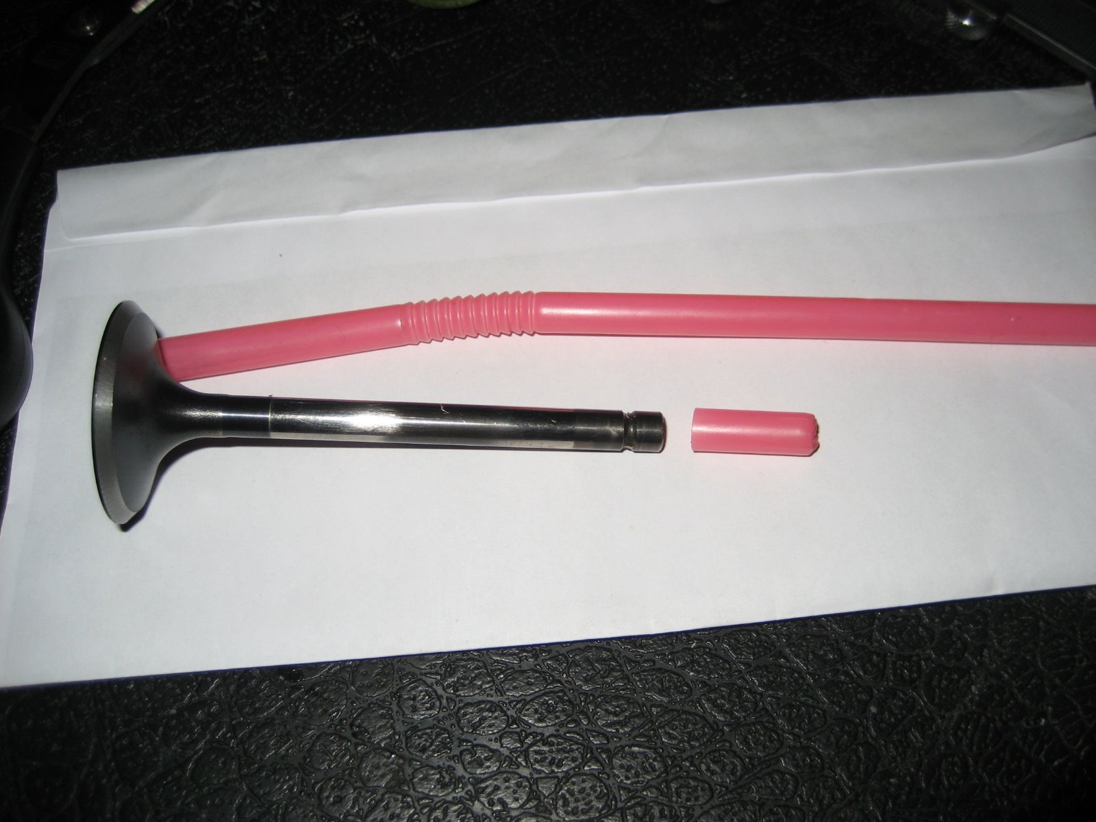

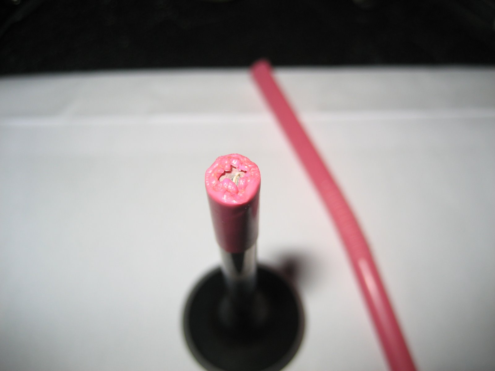

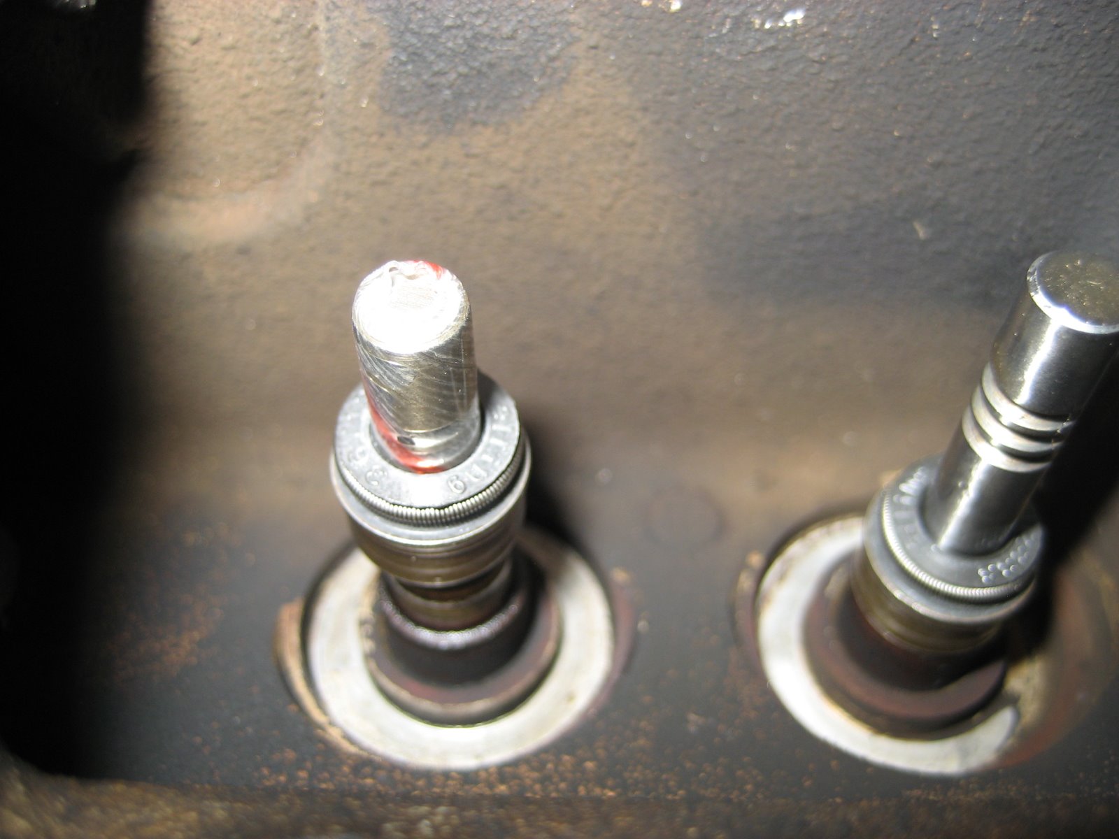

Just a hint, please use condoms to protect the new seals during the install. They will last longer smoke free.
or made DIY condoms...
happy wrenching...
happy wrenching...
