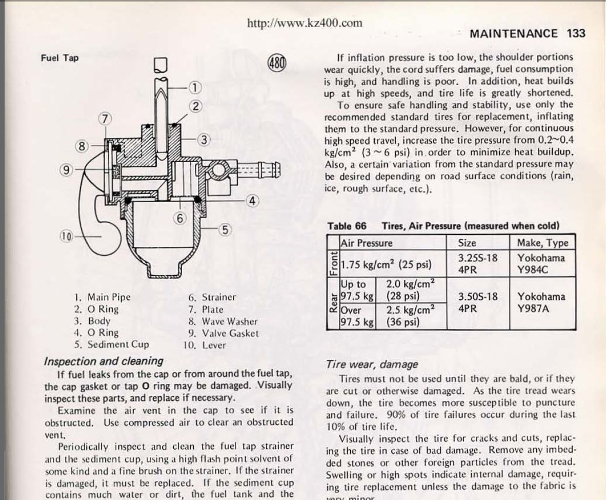

Which are the "little passageways" and if not cleaned with Cleaner, how should i clean them?
Do i need to remove petcock even though gas is flowing?
Kind regards
Kind regards

The little passageways are going to be most likely in the pilot circuit. Remove the jets and trace the circuit and make sure carb cleaner exits where it should when sprayed in. Basically you should trace every circuit and make sure they are clean.
Be careful with the petcock. Some parts for those KZ400 petcocks are NOLA.
