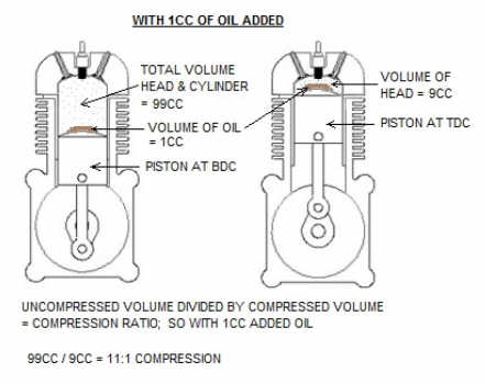

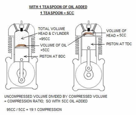

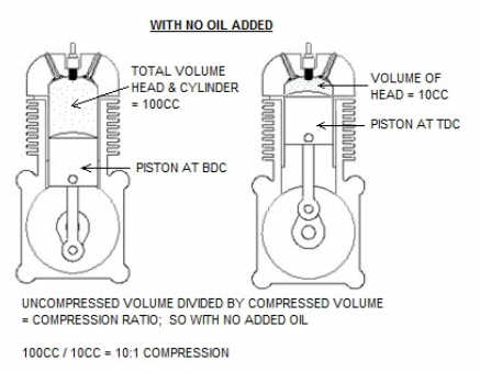

21 Jun 2019 10:26 - 21 Jun 2019 10:26Calvin9819 wrote: ................. put a little oil in there, compression went up.....................
Adding even a little oil will always makes the compression go up even in a brand new perfect engine. The diagrams below explain. Ed
