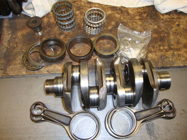

how would one go about removing race rods from a bad crank thats been welded
Re: how to cut good race rods off a welded z1900 crank that has a bad bearing
14 Jun 2019 16:30 - 14 Jun 2019 17:06

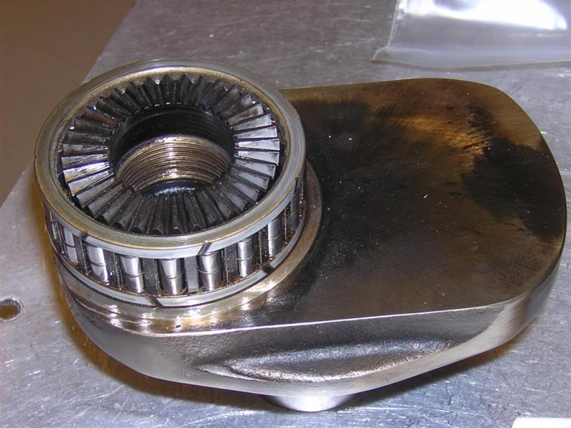

The only way is to mill away the weldings to separate/press out the crank bearing shafts.

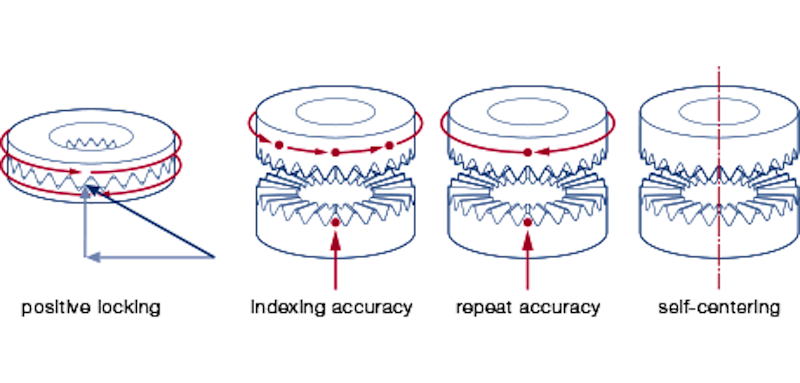

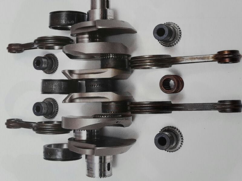

The famus Mercedes Silberpfeil and early Porsche race cars used demountable cranks (aka patented Hirth cranks ).

Very interesting design which I have never seen before. Thanks for sharing.
