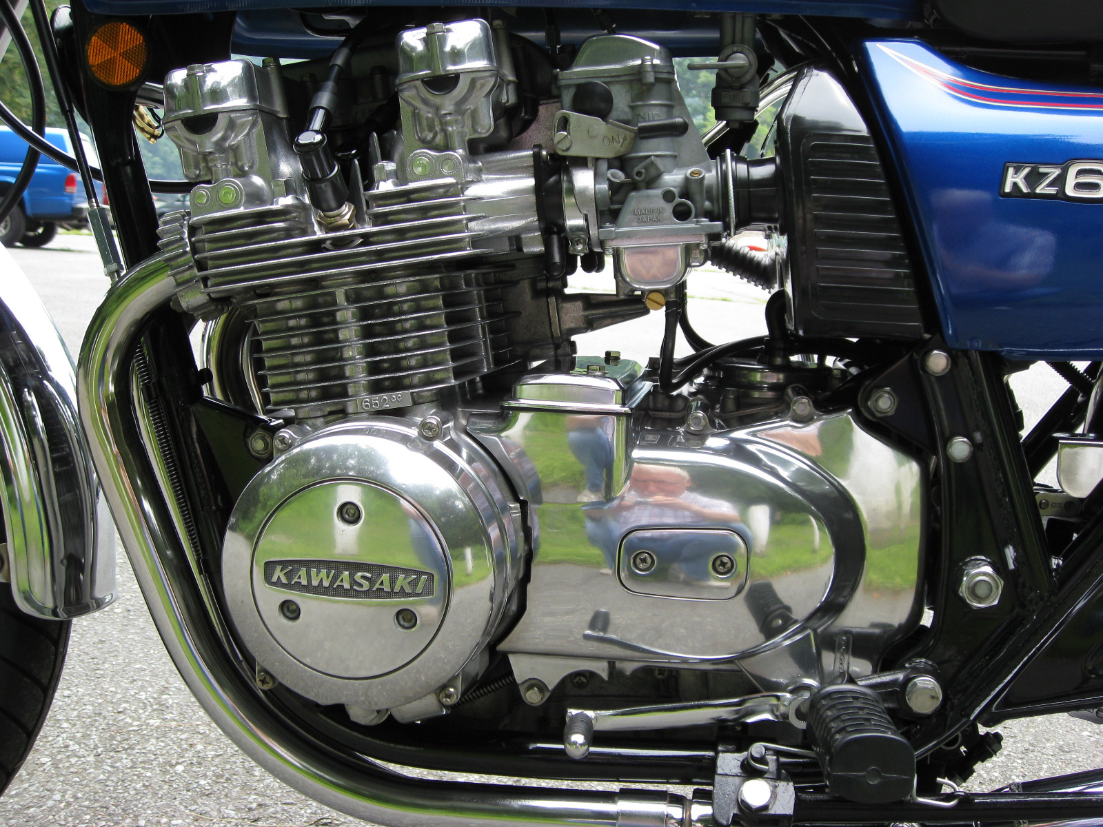

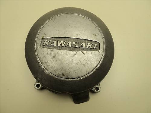

Where is the "KZ650B3" number stamped? The actual engine serial number should be stamped next to the oil filler cap, and it should not have KZ650B3 or any other specific KZ650 model number stamped there. It should be stamped with KZ650BE024200 where those last 6 digits represent the actual engine serial number. If you post that number we should be able to verify the engine's year beyond any doubt. The reason I said it is a 1977 KZ650 engine is the fact that it has the 3 allen bolts in the generator cover. No other year KZ650 had those bolts because that generator was only used in 1977. After 1977 the generator cover had no allen bolts. Below is a photo of the generator cover on my 1977 KZ650 and a 1978 cover. Ed
1977 COVER
1978 COVER
1977 COVER
1978 COVER
