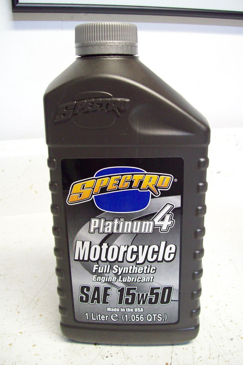

I have been very partial to Spectro Oil products since I found out about them back around 1980 or so. Their oils were the first synthetic oils I found that when you looked inside you motor, it didn't have that dry looking film on like the cams, and shim buckets like most synthetic oils did back then. It had that wet look to it like the petroleum oils did. Both my GSXR and Kz1000 motors have run on their Platinum Full Synthetic 15w50 for many years now with nothing but positive results!!!! All my motors are broken in on good old dinosaur oil for the first few hours of running then I switch to full synthetic.
