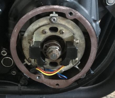

When I took off the cover today was it wet inside... maybe condensation. It looks like the paper gasket have transported the water from outside?
When I installed the gasket I was not doing anything with the gasket it self.....
Now sprayed some silicon spray on it...
What are you doing to avoid water / condensation ?

Under the gasket, ignition cover, should be a vent gap/bore @ 6 o´clock Position to drain the water/moisture.

10 Jun 2019 14:38Scirocco wrote: Under the gasket, ignition cover, should be a vent gap/bore @ 6 o´clock Position to drain the water/moisture.
Maybe smart to install some Silica Gel also ?
