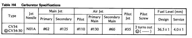

If it was lean, then does it make any sense to decrease the air main jet? To restrict air flow? Just wondering if it works the other way around.
Also, I'm working on a KZ750, so the jets are probably different sizes. According to my manual, these are the jet sizes.
According to the DynaJet manual, the stage 3 jet sizes are #122 and #136.
