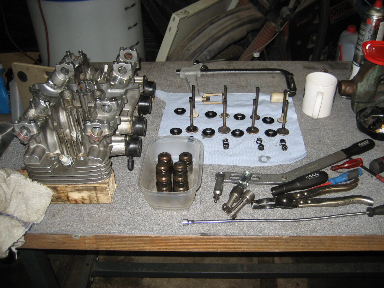

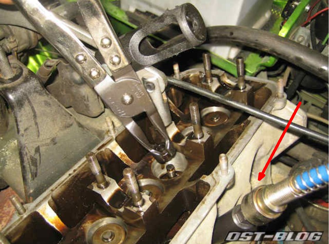

If you put the Piston on TDC you can remove the valve springs and valve stem seals.
An other option is to put compressed air into the spark plug hole.
and i use the VW valve seal tools i have modified for the KZ heads.
I never have to pull any car or bike cylinder head for a valve stem seal change.
If someone is interest into the KZ650 donor head, it´s a free give away without the retainers and buckets.
