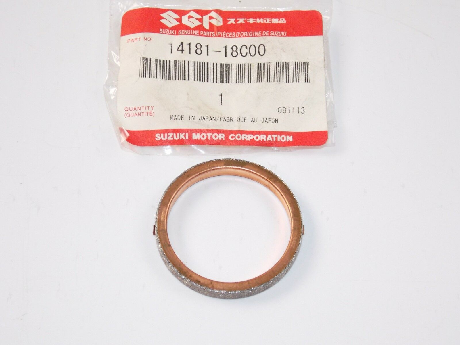

Thanks Scirocco, found a couple of rings with very similar measures at the Honda shop and will go with those
but found yours on Evilbay too so next time...
