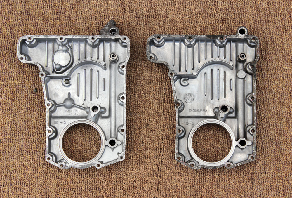

Zephyr 750 oil pan fits KZ650 and there is no issue with oil lines of Zephyr 750 oil cooler: there is still a gap between oil lines and crankcase.
Zephyr 750 and KZ650 oil pans to compare:

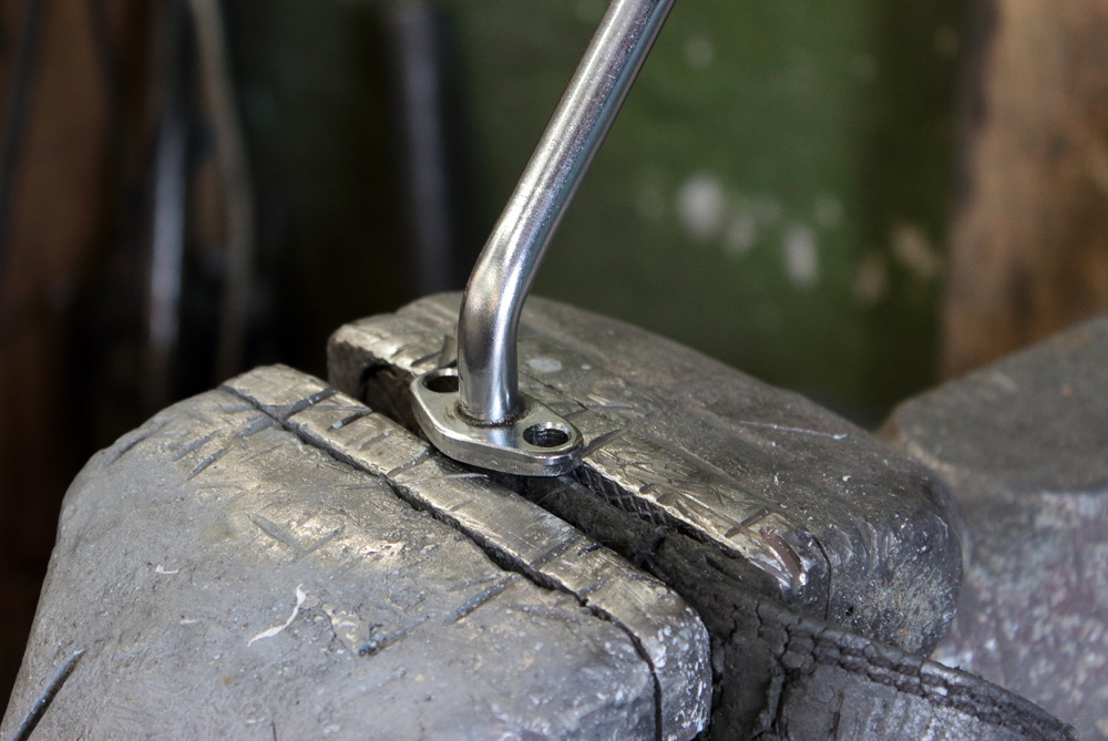

weeZee: Sorry, looks like I misguided you. I have two sets of Zephyr coolers and lines. One of them is installed on my KZ650 project bike as a model and yet another one (which is in perfect condition) lies in box and wait to be installed on finished bike. I took lines from that newer set and checked: the line that to be mount to lower oil pan port fits without issue but line for upper port couldn't be installed until its first bent aren't slightly unbent.
However it's simple to do. All you need is old 7mm bolt (or some rod of same diameter), valises and bare hands.

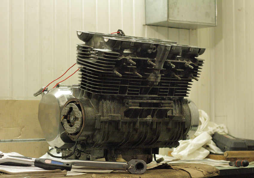

I'm confused by the highlighted sentence. Could you explain further?
I have only this old photo to illustrate what weeZee said. As you may see, unlikely to KZ650 and KZ750 Zephyr 750 crankcase has only one front mount, on upper half of case.
