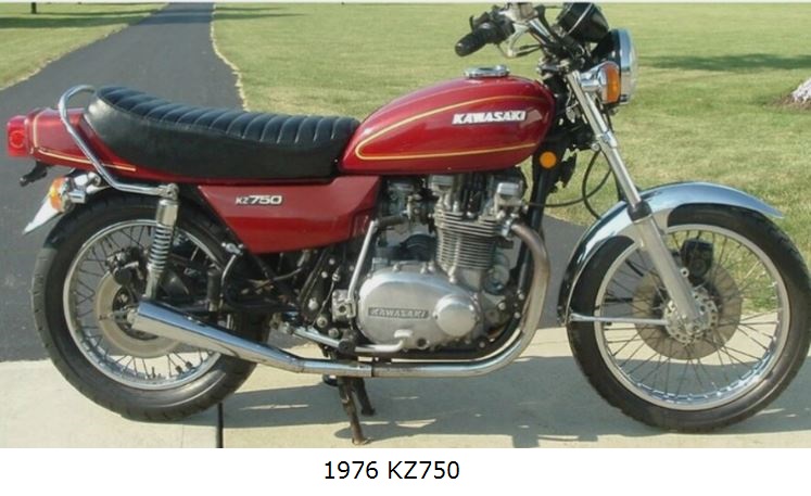

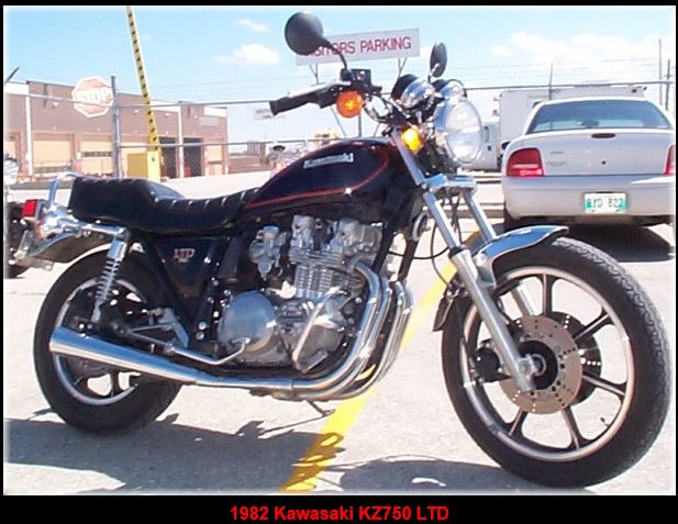

Will a gearset from an earlier KZ750, lets say a 1976 KZ750, fit into a 1982 KZ750 LTD? Are the ratios the same? My bike is popping out of 2nd under load (and finding a false neutral in 4th) so I'm thinking it's time to freshen up the trans. Thanks for your knowledge :)

Consider the following - the 1982 KZ750-LTD is a 4 cylinder motorcycle. The 1976 KZ750 is a 2 cylinder motorcycle. The two models share very little. So when considering finding parts for a 4 cylinder KZ750 it would be wise to look at other 4 cylinder KZ750 bikes. Ed

In your original posting you asked "Will a gearset from an earlier KZ750, lets say a 1976 KZ750, fit into a 1982 KZ750 LTD?" The 1976 KZ750 is the KZ750-B1. Since that's the bike you mentioned that's the bike I referred to. If you look at the part numbers for the 1976 KZ750-B1 vs. the 1982 KZ750-LTD you should see that the part numbers are in fact different. Notice the different part numbers for gear, shafts, etc. between the first diagram below for the 1982 KZ750-LTD and the second diagram below for the 1976 KZ750-B1. They all look different to me. Ed
