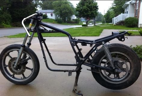

09 May 2019 14:19650ed wrote: Here's a pic of a KZ440 that's bored all the way out. :laugh: Ed
I though that was going to be a stack of washers. :laugh:
