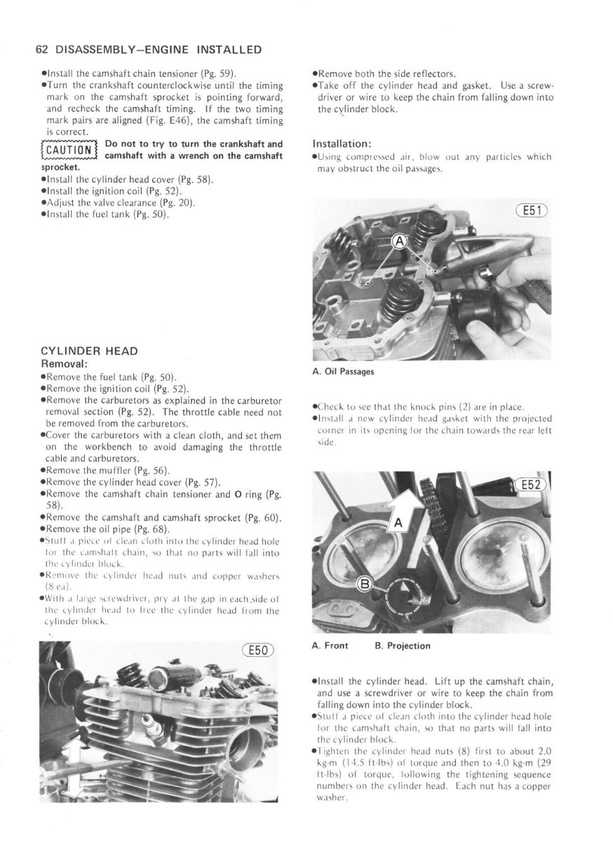

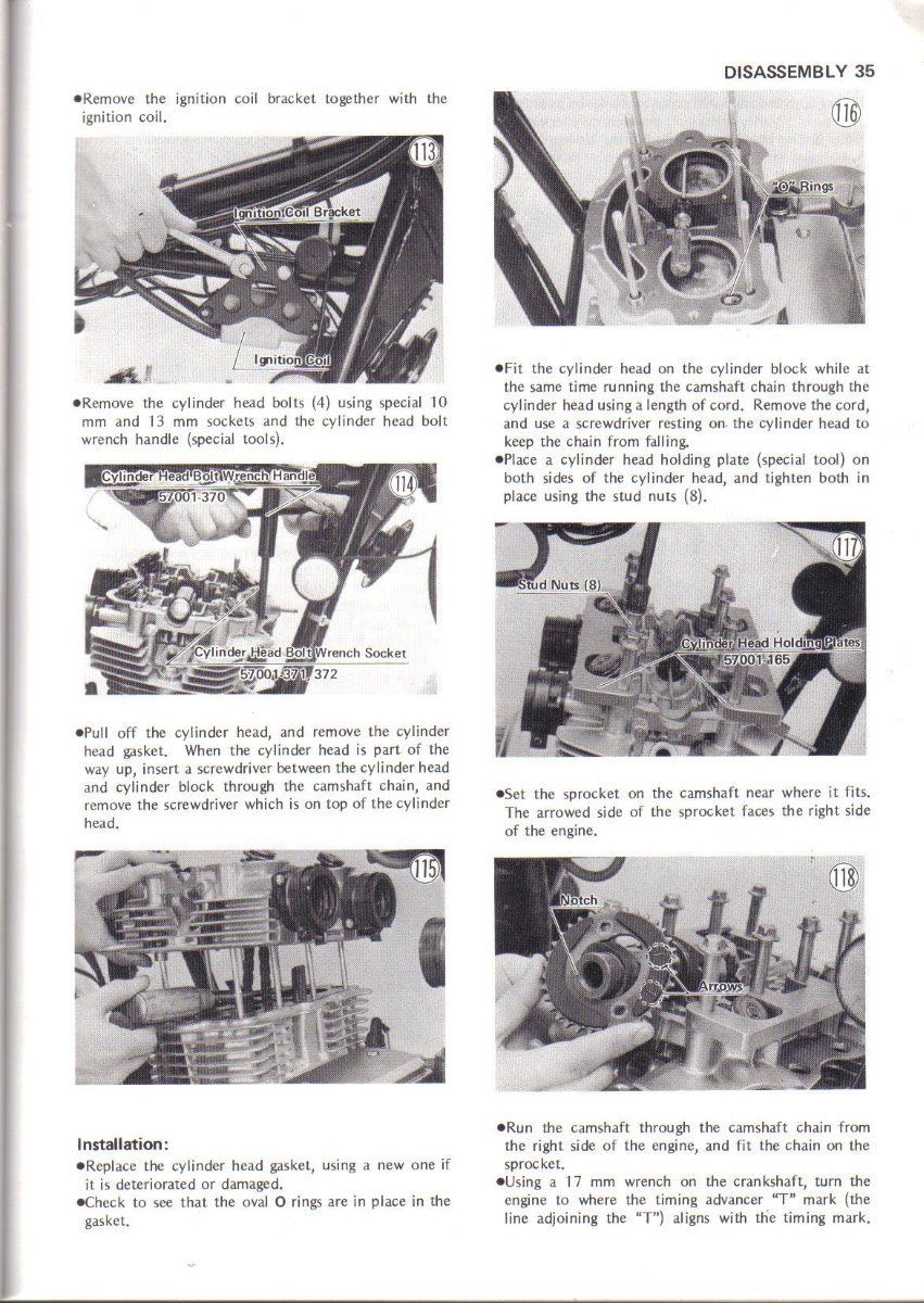

Suspect a head gasket leak on my 1982 KZ400 LTD - can the head be removed with the engine remaining on the frame or do I need to remove ? Thanks

the head can be removed with the engine remaining on the Frame on near all early Kawasaki bikes.
KZ400 early models
KZ440 later models

When in doubt, open the manual...
www.kzrider.com/service-manuals
