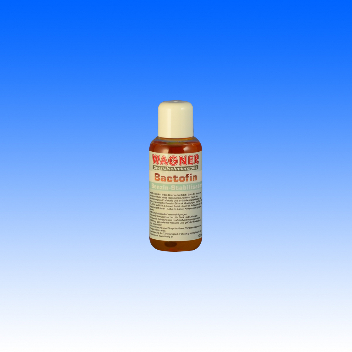

Re: Fuel 95 & 98
29 Apr 2019 15:18
to avoid corrosion in the tank over the winter time or longer storage to stabilize the fuel use Bactofin.
100 ml stabilize 100liter of fuel.
www.korrosionsschutz-depot.de/wartung/kr...en-nicht-fuer-diesel
