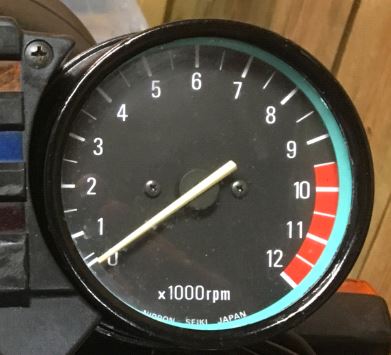

Here is photo of it:
I need to try to take it out and see if I can loosen it up....

Since the inner cable is getting twisted/broken, it sounds like the tachometer must be seized or something. guessing.
I would install an old cable into the tach & try to spin it by hand or use a drill to spin it. If it won't spin, then the tachometer is probably broken or something.

Sounds like the grease inside the tach has gotten stiff. You can open the tach by carefully prying off the bezel and then you can look for problems inside. Baking the tach at 60C for an hour or so will soften up the grease some too.

I took the tacho out today and sprayed some silicon lube in the whole and used a small screw driver, and suddenly it started to turn around...
I used a electrical screw driver connected to the wire and got 7000 RPM
hehe
So for now its working perfect
Only need to receive the new tacho wirer....
Will test the tacho before I install the new wire so I don`t break one more
