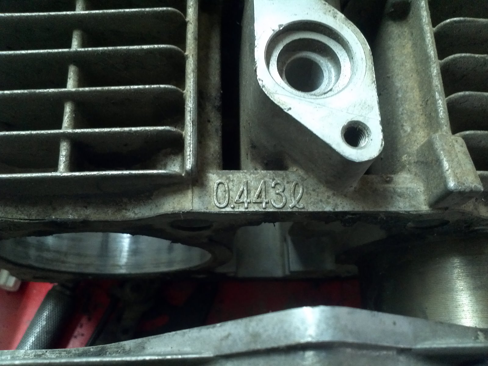

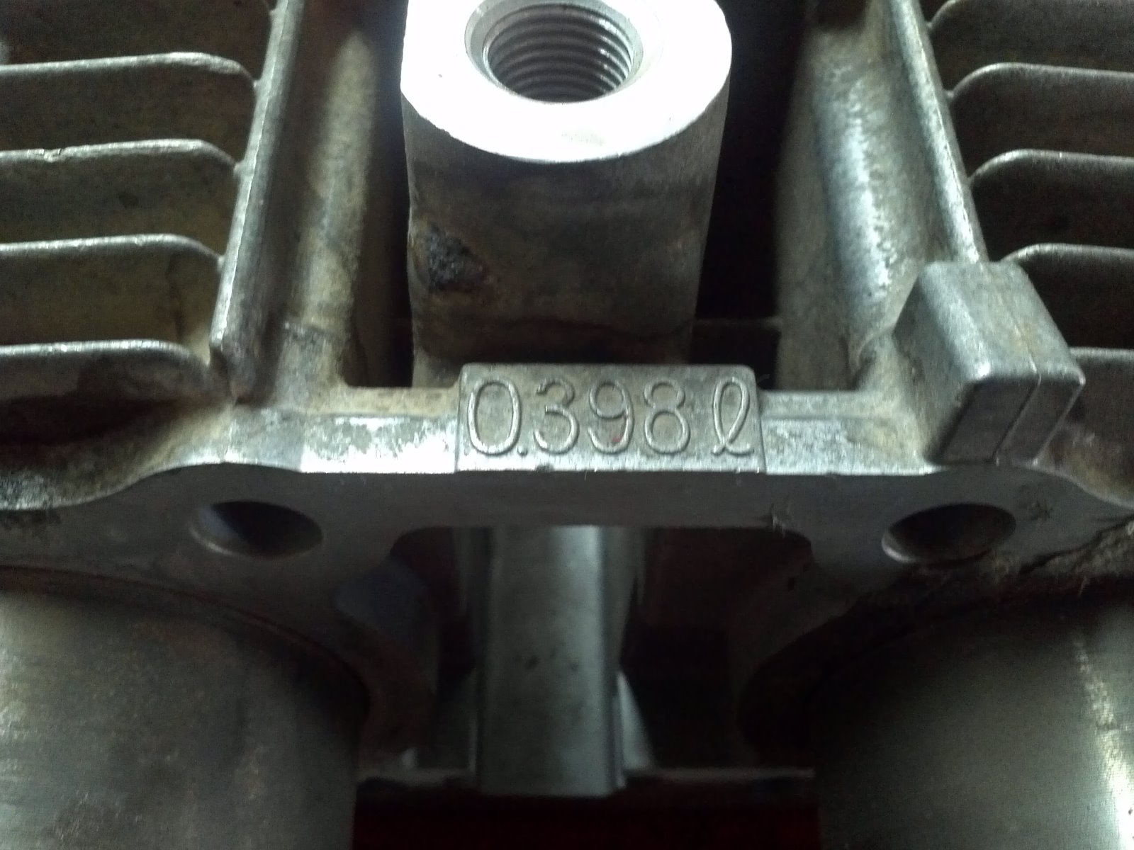

Your bike should have a kick start from new. What is the engine number? [ It is located by the oil fill cap ]
What is the engine displacement? [ It is cast into the front of the barrels ]

21 Apr 2019 07:56Riddell wrote: Engine number: K4E 173942
Closest I could come up with is a 1980 B3 or G2 model KZ400.
How about some pics of the clutch cover?
