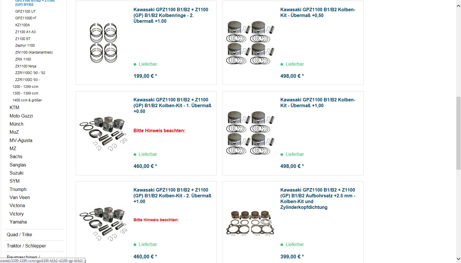

For the me the best source for piston upgrades.
www.scheuerlein-motorentechnik.de/motorr...-b1b2-z1100-gp-b1b2/
Re: Zn1100 pistons
18 Apr 2019 13:41
The 1984 GPZ1100 (UT) has 18 mm Piston pins!!!
Your 1985 zn1100 has 17 mm Piston Pins.
