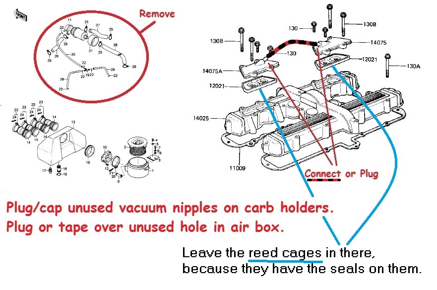

What vacuum parts were missing?
- kaw corral
- Banned
- Lets build one!
- Posts: 16
Re: Cold cylinder, miss after warm up.
15 Apr 2019 06:16
Someone had connected the valve cover vents together, and the large vacuum piece that connects them to the air box is missing, and the 1&4 intake boot tubes were blocked off with a screw.

15 Apr 2019 11:47kaw corral wrote: Someone had connected the valve cover vents together, and the large vacuum piece that connects them to the air box is missing, and the 1&4 intake boot tubes were blocked off with a screw.
It's common practice to remove the stock "clean air" paraphernalia.

Actually, the lack of clearance suggests that they have not been shimmed at all. This is a very common problem as too many owners are too afraid to do it themselves and too cheap to pay. The valves pound their way deeper into the head, slowly reducing the clearance until there is none. Then burnt valves.
You will want to plug the hole in the air box and insure that the plugs on the carb vacuum ports are soft and sealing well.
