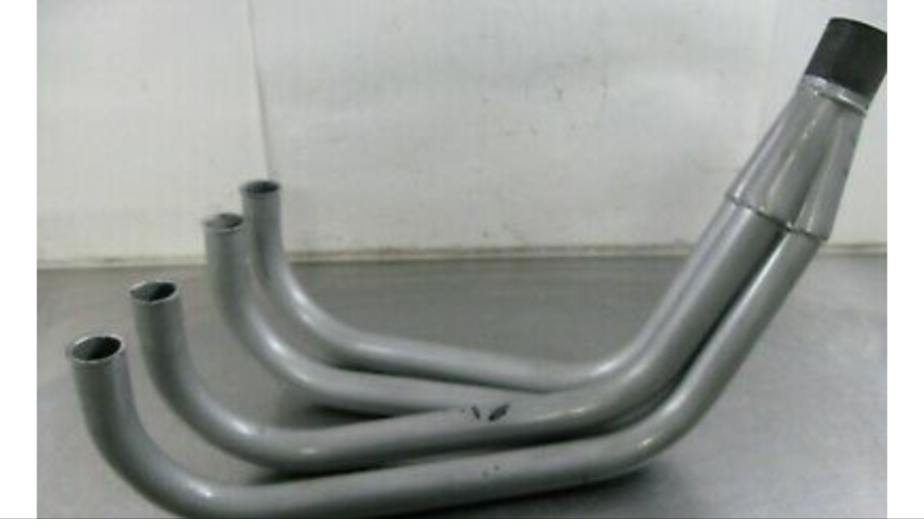

Hi, I have an exhaust like the one pictured, and can’t find any info on mounting hardware.
Does anyone know about this type of exhaust?
Thanks.
Thanks.

Stock flanges with the half moon pieces?
Re: Exhaust mounting
13 Apr 2019 16:40
Do you know the OD of the header pipes?

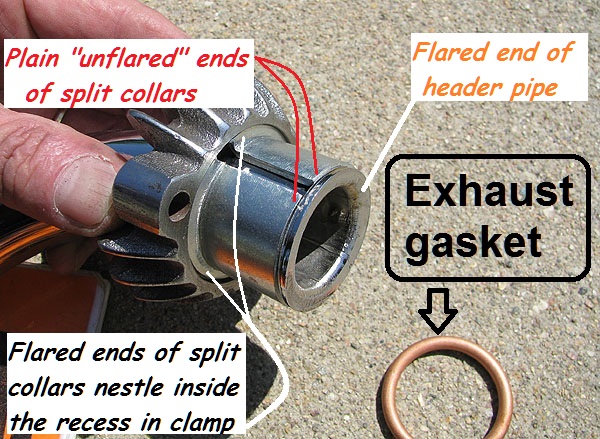

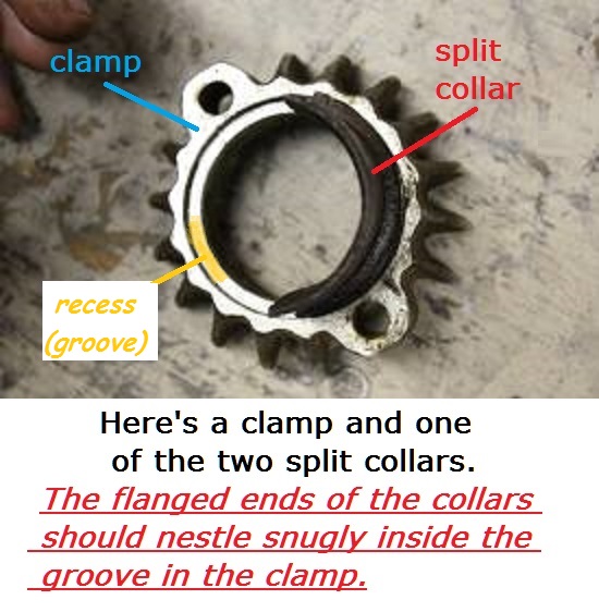

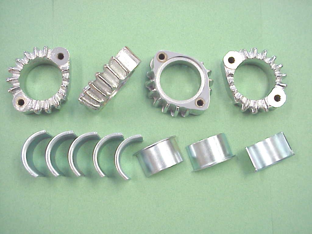

Don't know exactly which KZ you have but to mount this pipe to most Kz's
You will need the following parts, 4 exhaust flanges, and 8 split collars And 8 nuts and 8 lock washers!!!
I believe this photo is of Kz900/1000 type flanges and split collars.

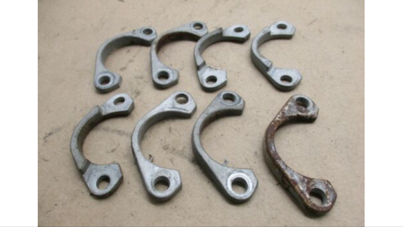

14 Apr 2019 04:29Those look like what came off the stock exhaust on my 81 Kz750

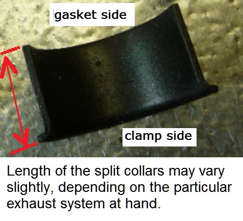

What motorcycle is it?

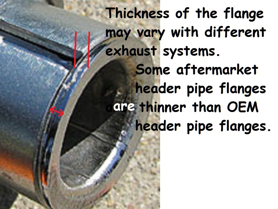

You'll need the correct exhaust holders & correct half-moon exhaust collars from a 70s model. Most if not all of the 81-on models have shorter exhaust collars & won't work with that exhaust header. 1980 was kind of a transition year, so some Kawasakis had the short ones & some models had the long collars.
