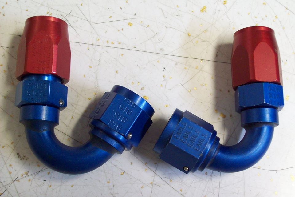

they have a early model version. I wonder what the fitting size is. the stock fitting needs a 12mm ID. most i have seen are much smaller than that.

All the hose and hose ends I have ever seen used on Kz900/1000 oil coolers were -8 in size. Which should be 1/2 ID hose. That has been the size used on all the Superbikes since back in the day. I have never seen a Kz900/1000 use any hose bigger than a -8 hose and fittings going to a Earl's cooler.
The Kz1000S1 had an extra fitting screwed on to the Earl's cooler to reduce it down to -8 hose.

Interesting. I bought an adapter a little while back at thought I couldnt run it because the fittings were too small.

I bought one and it said 1/4" NPT. I was able to find 1/2" ID NPT fittings at the hardware store.
