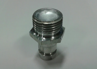

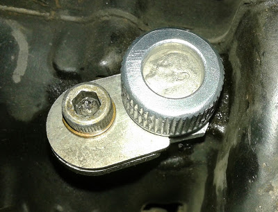

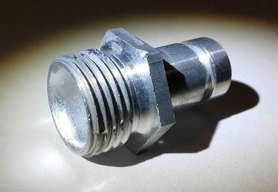

Theoretically, the tach spindle (pinion) should not leak even with the cable removed... but they all leak.
I always remove the pinion because it interferes with camshaft installation if you forget it's there. That can break a cam or strip the cam bearing bolt holes.
My buddy and I found a way to seal off the pinion port in the tach fitting. We used allumalloy to seal it off. Make sure the oring is in good shape and there should be no leak. :
