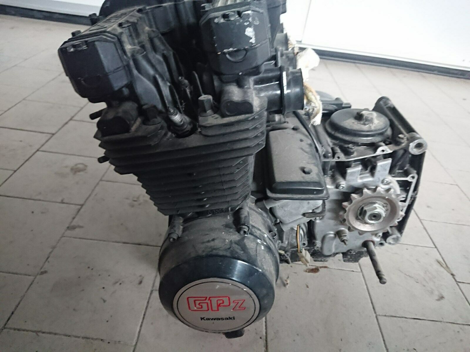

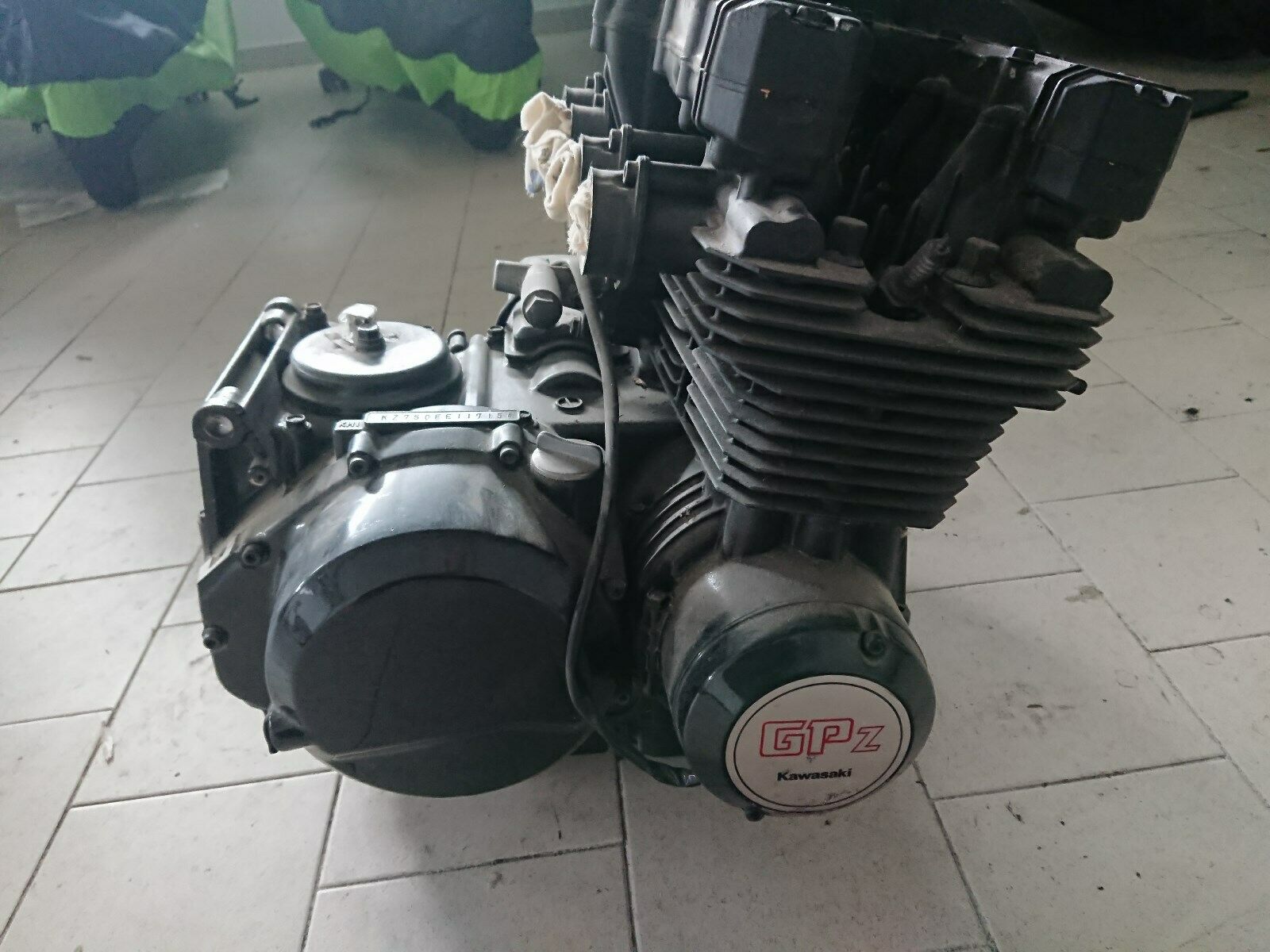

No eBay APP ID and/or Cert ID defined in Kunena configurationI would buy a complete used engine, who knows anything else can be damaged as you knowing yet.
Engine plus the carbs for 199 Euro
