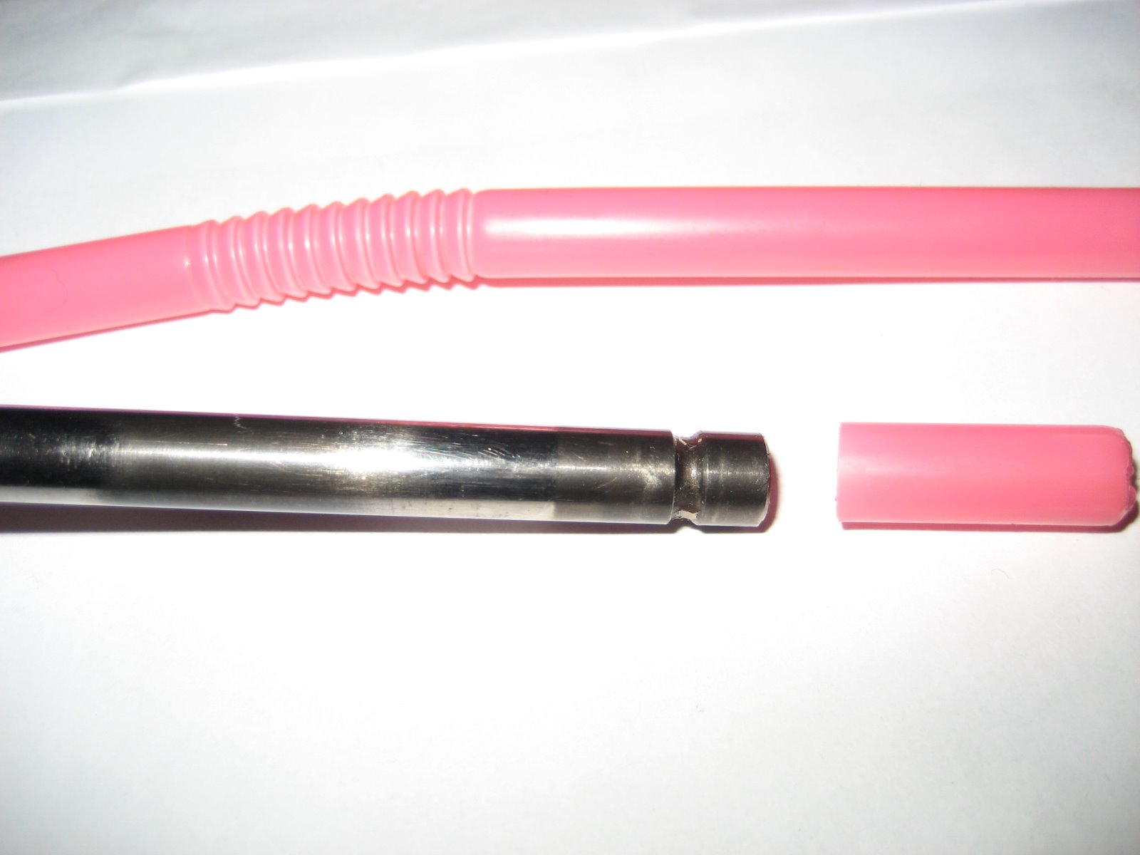

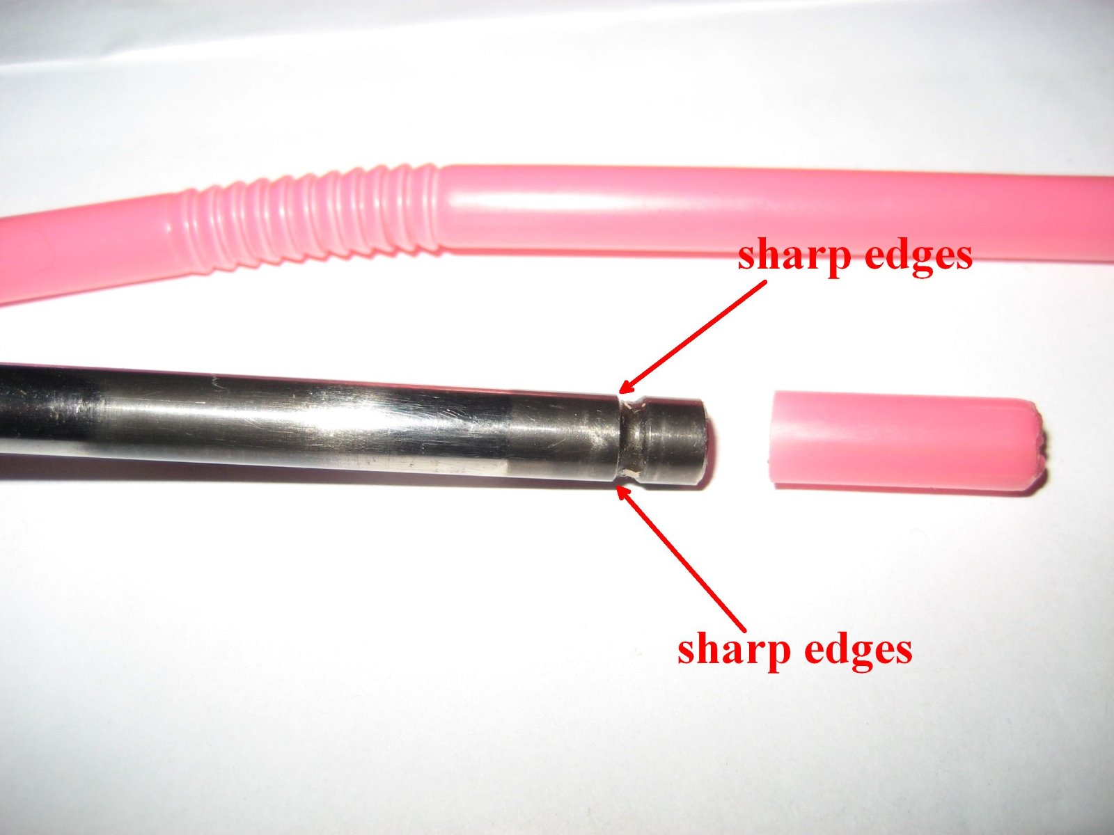

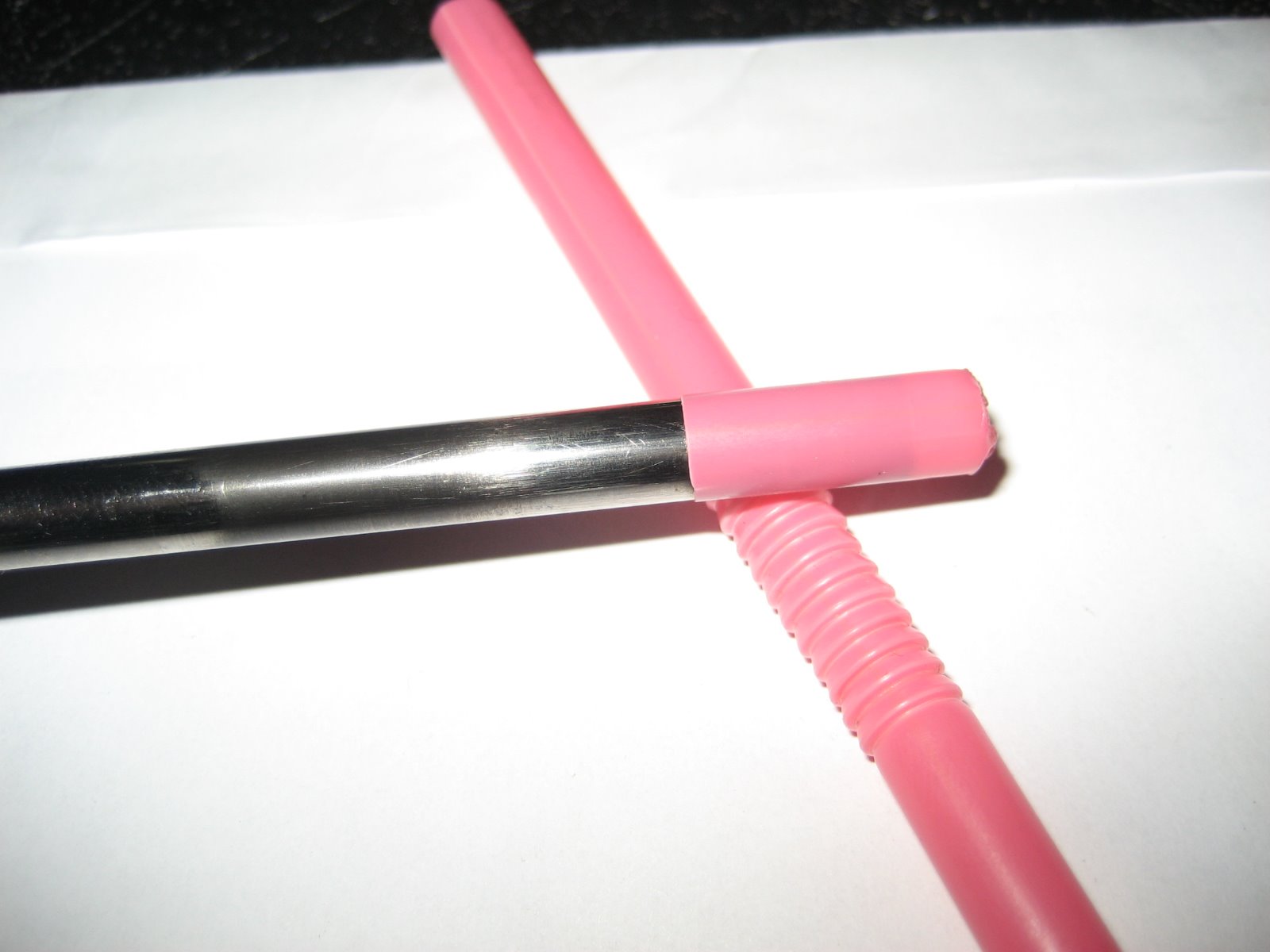

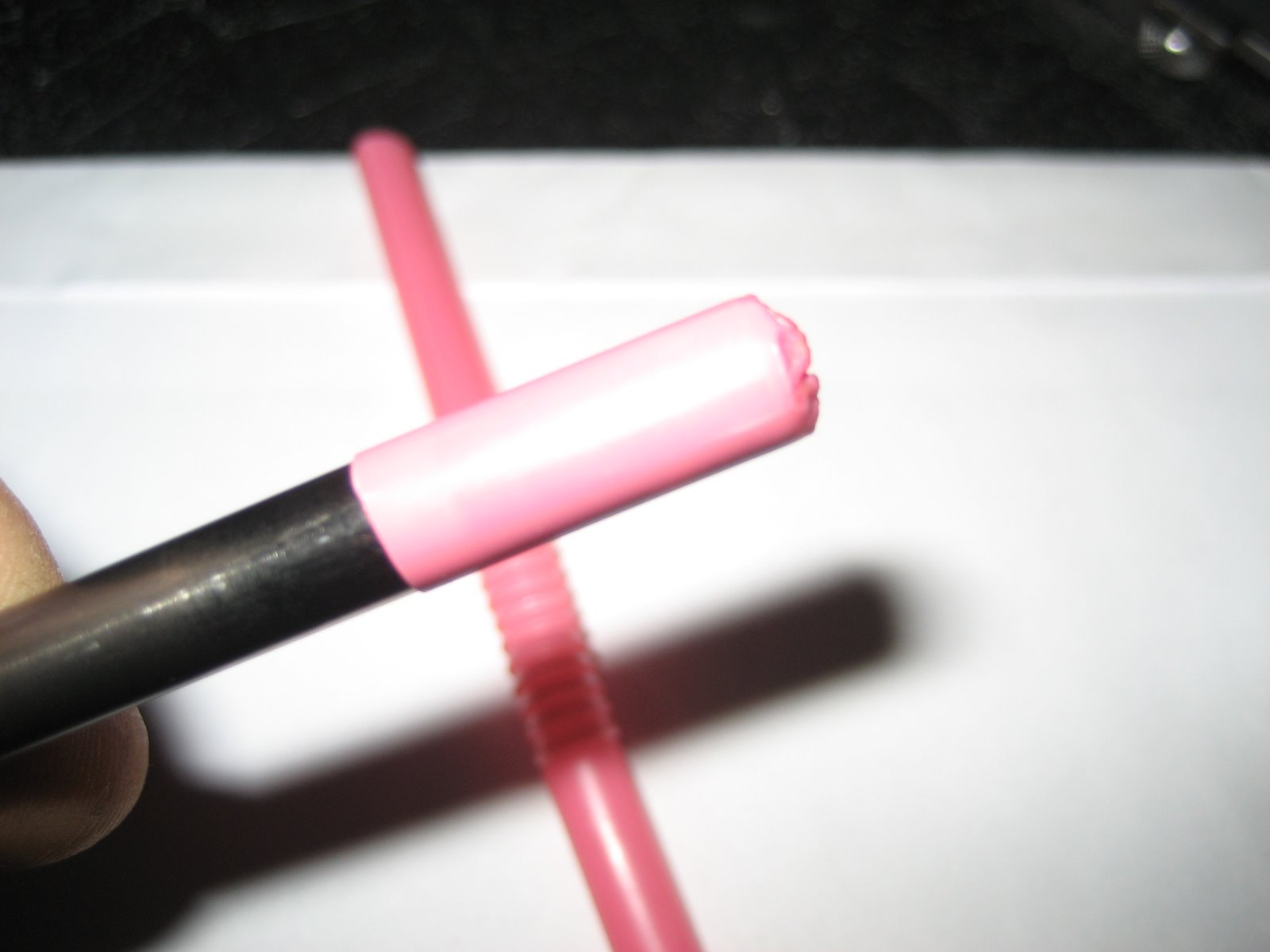

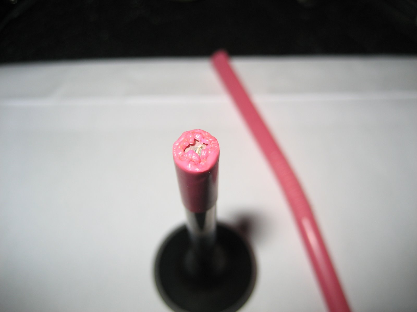

Viton valve stem oil seals are the best you can get fot Money.
Please use a "condom" for the install to prevent any damages of the sealing lip!!!
or made your own condom out of a 7 mm drink straw
