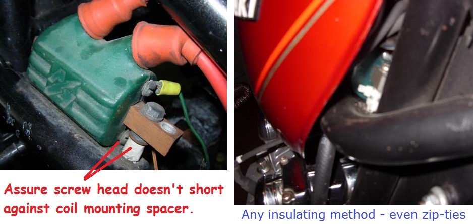

And would also assure that screw heads at the primary coil terminals are not too close to metal coil spacers so as to ground when a film of water gets between the screw head and a ground. A zip tie wrapped around the spacer makes a good insulator between the screw head and spacer.
