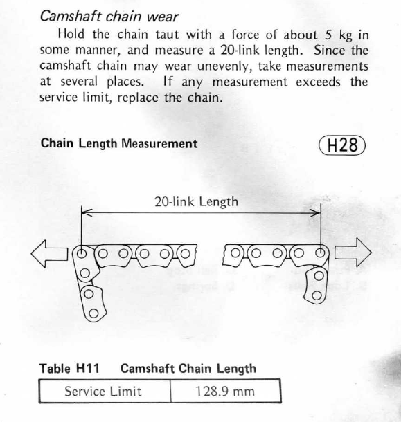

07 Mar 2019 17:20 #799901
by Nessism
Replied by Nessism on topic Timing chain
The following user(s) said Thank You: bluej58, gordone
Less
More
- Posts: 3035
- Thank you received: 1090
07 Mar 2019 17:34 #799903
by hardrockminer
I have several restored bikes along with a 2006 Goldwing with a sidecar. My wife has a 2019 Suzuki DR 650 for on and off road.
Replied by hardrockminer on topic Timing chain
About a year ago during the rebuild of a Z1B I had the engine torn down to the cases. I checked the timing chain and it was within the spec mentioned above. So I left it in and rebuilt the engine. I noticed when I installed the top guide that there was more slack than usual but it seemed to tighten down OK so I went with it. During startup the chain jumped, messed up the timing and bent three valves. I tore the engine back down and replaced the chain as I should have done in the first place.
The following user(s) said Thank You: Street Fighter LTD, gordone
