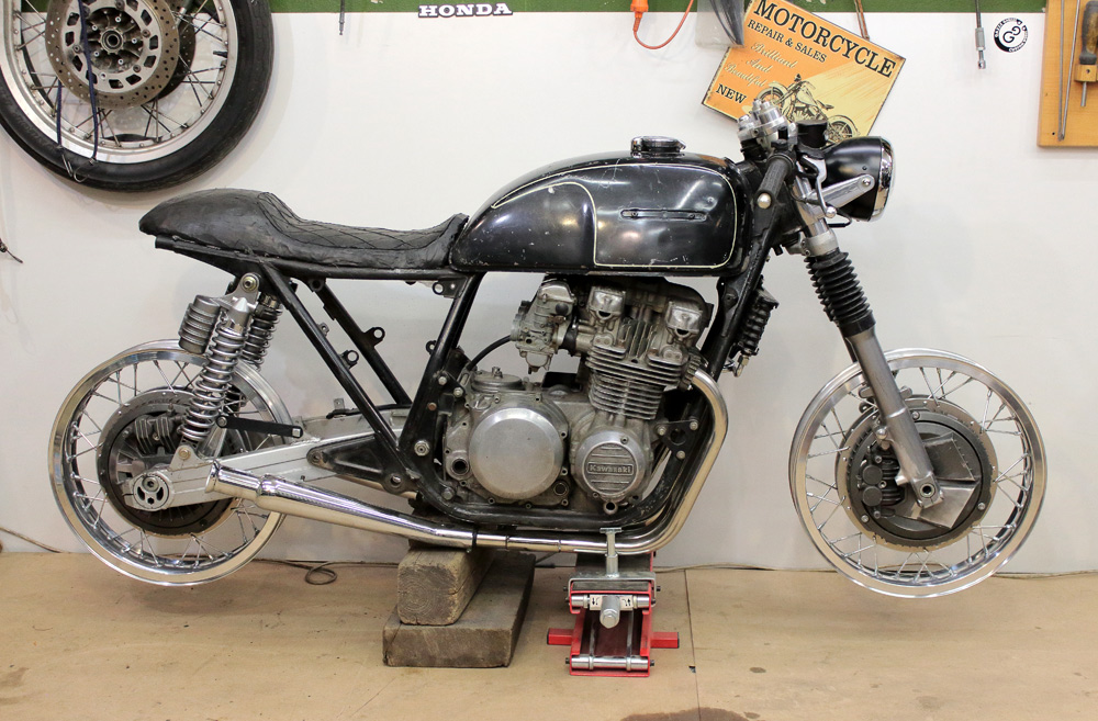

Zephyr 750 header fits KZ650. I am a longtime owner of Kawasaki Zephyr 750, so when I started working on KZ650 project I have no hesitation about exhaust. My choice was for stainless header from Black Widow Exhausts.
