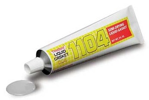

I have been using Three Bond #1104 semi-drying case sealant since back in the 70's. And I would not use anything else on my case halves!!! It is what Kawasaki used on their case halves when they built the Z1's, Kz900's, Kz1000's, and about every thing they built back in the 70's to the 90's.
Its sold by Yamaha as Yamabond. Forgot what Suzuki and Honda sold it as. It is grey in color. Don't know if Three Bond has updated the #1104 number to something else in the past few years. I know it as TB-1104.
