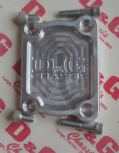

D&G Chassis Custom Parts offer a Kick Starter Block Off Plate for Kawasaki.
I don´t know about the bolt pattern is the same on your KZ650 engine???
www.dgchassis.net/Dragbike%20parts/dragbike-parts.aspx

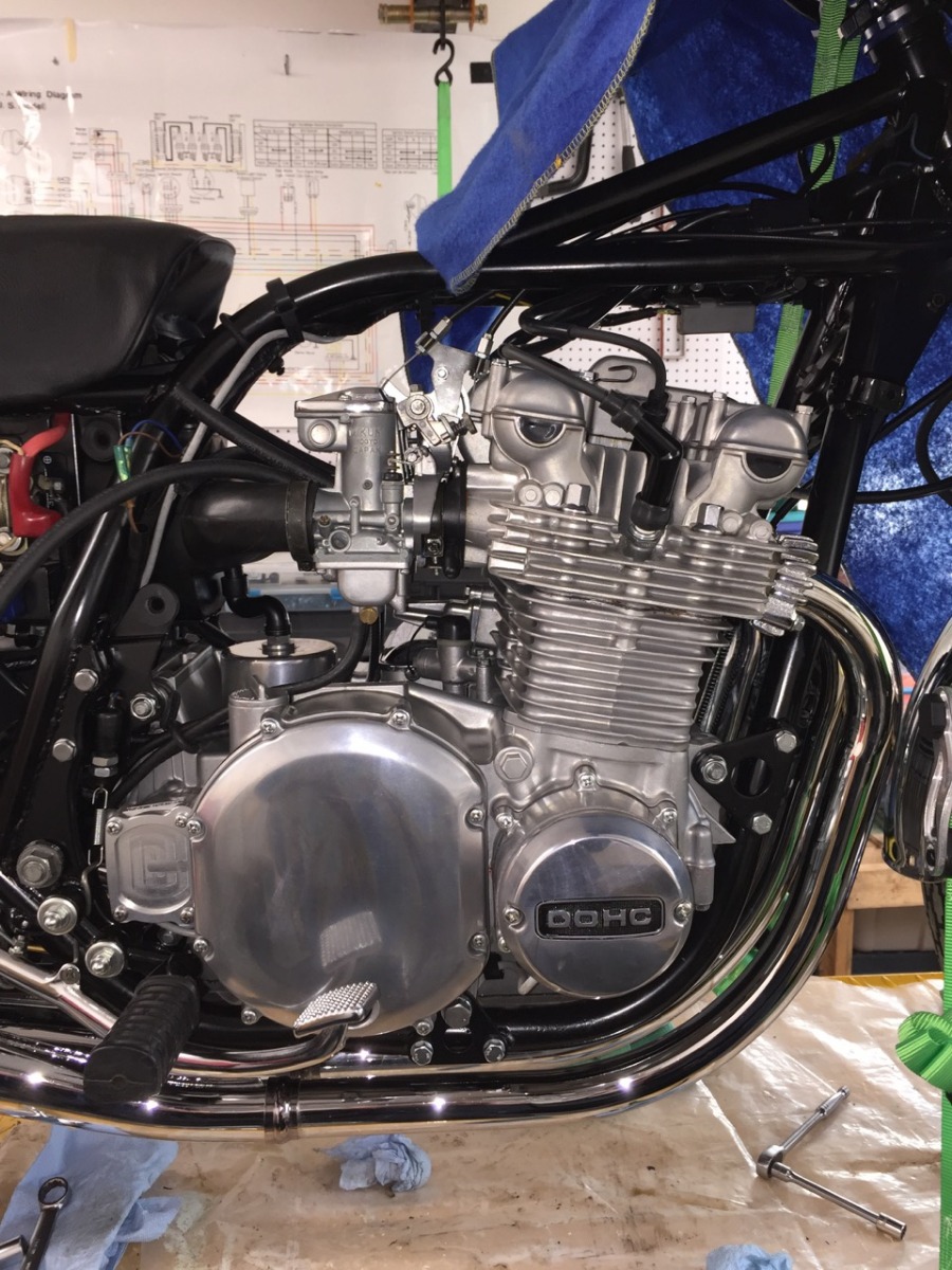

Here is what one looks like installed on a Z1B.

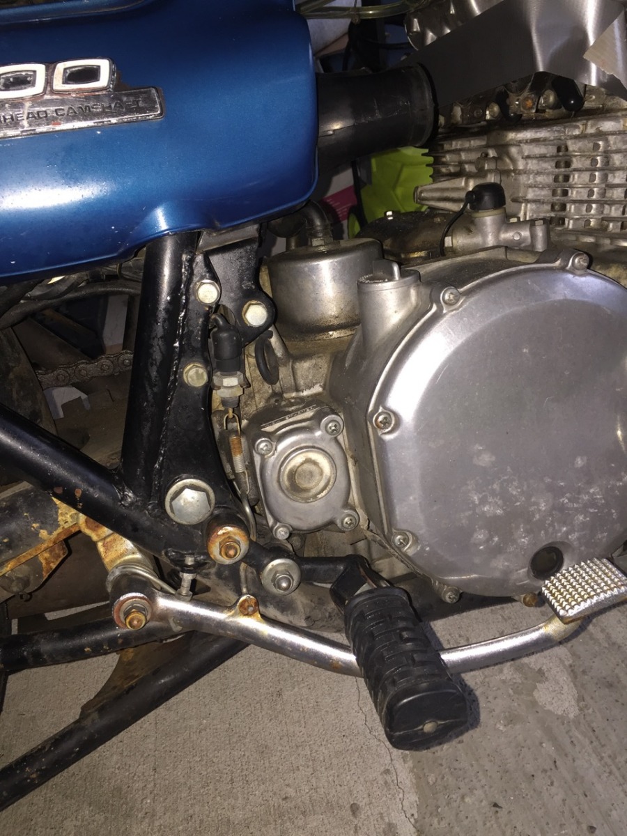

Not to steal your thread, but there is a story behind that plate..I wanted to restore the bike to original condition but every time I put the engine together and fire it up I could hear noise from the kick starter. I tore the cases apart five times trying to find the problem. Finally someone a little more experienced told me to check my transmission. Turns out someone had installed a close ratio transmission, and the driving gear for the kick start (1st gear) was a bit smaller in diameter than a standard gear. So the gears would not mate correctly and lots of ratchet noise was occurring. The last time I put the cases together I pulled the kick start out and plated the hole, which was how it was when I bought the bike. There isn't any oil pressure behind the plate, but oil comes and goes because it's connected to the sump. So all you really need to do is find something to fill the hole where the shaft protrudes. Here is what the the PO did.
