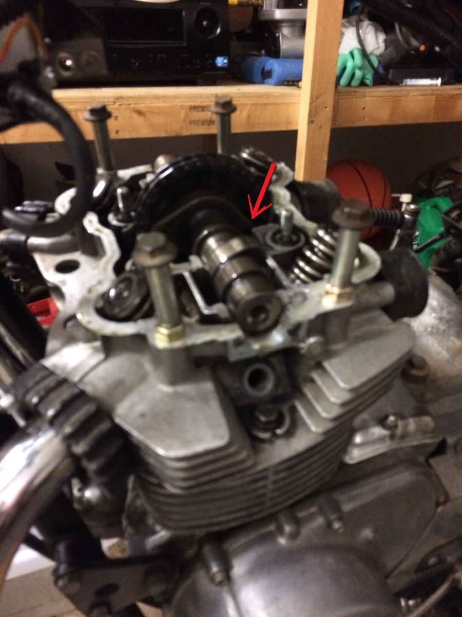

Hi guys.
I performed a leak-down test this evening (thanks Patton) to find where oil is getting into the exhaust, and gas into the crankcase oil.
I removed the cylinder-head cover to get a good listen at the individual valves.
At 30 psi into the plug holes (both), there was a gentle whoosh sound coming out of the crankcase opening by the timing chain (red arrow), and nothing at the valves, so at least my re-seating did the trick.
So: should there be no ingress of air past the piston rings, or is a little bit expected due to the ring splits?
Thanks in advance.

Head Gasket blown or rings stuck/worn. Depends if it is truly coming between cyl and head or blowing down liners and up-sweeping thru crankcase tunnel. How much air/% of loss?

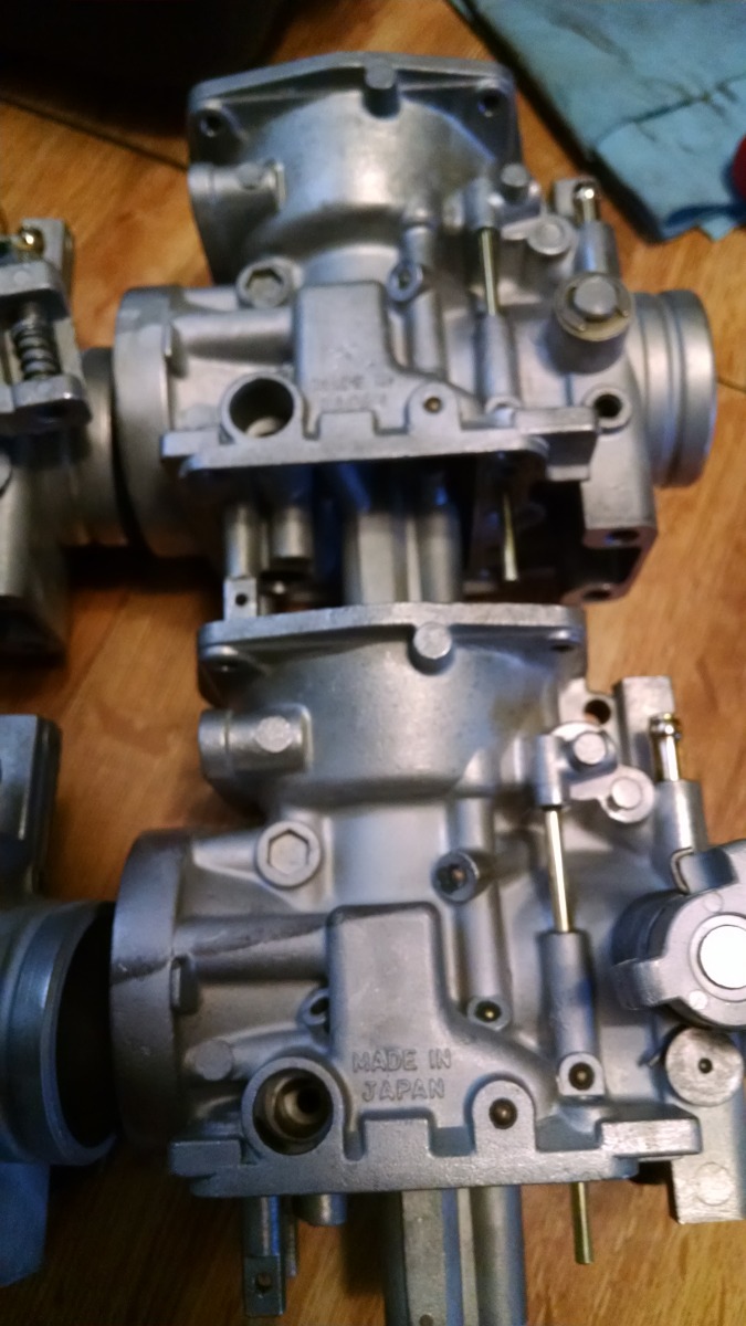

The gas tank fuel cock shuts off fine, it's just that when I switch on fuel before starting, gas immediately waterfalls out the overflow nipples.
Overheat in left cylinder occurs within 4-5 minutes at all throttle settings. It was a crisp and breezy -10° outside the last time it ran and overheated, so there's plenty of cooling going on. Low-speed idle needles are opened out 3 turns to get lots of gas in there.
I already honed the cylinder walls during the top-end rebuild, and lapped the left-side valves while I was at it. I'll tear it back down and lap all 4, replacing the valve-shaft oil seals while I'm at it. Sound reasonable? I'll get shopping on Z1.
Edit:
Upon carb teardown, left carb high-speed port was thoroughly clogged. That'll learn me for not being more thorough in the first place. Hopefully this fixes the overheat problem.
Have a few carb and valve seals on order. Further updates as events warrant.
