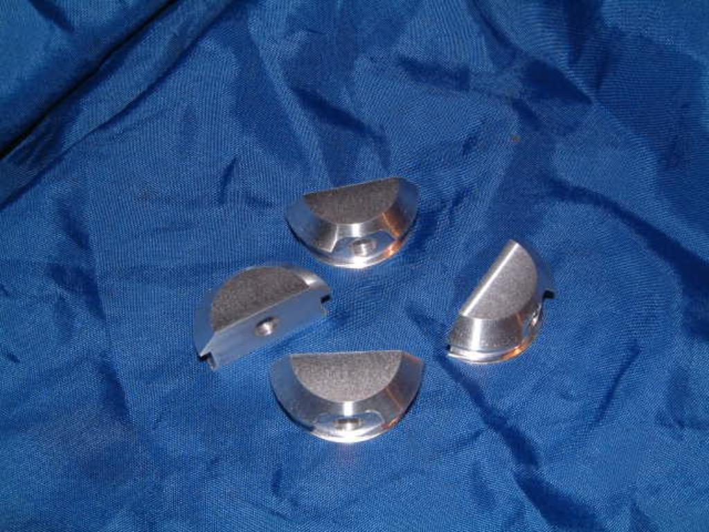

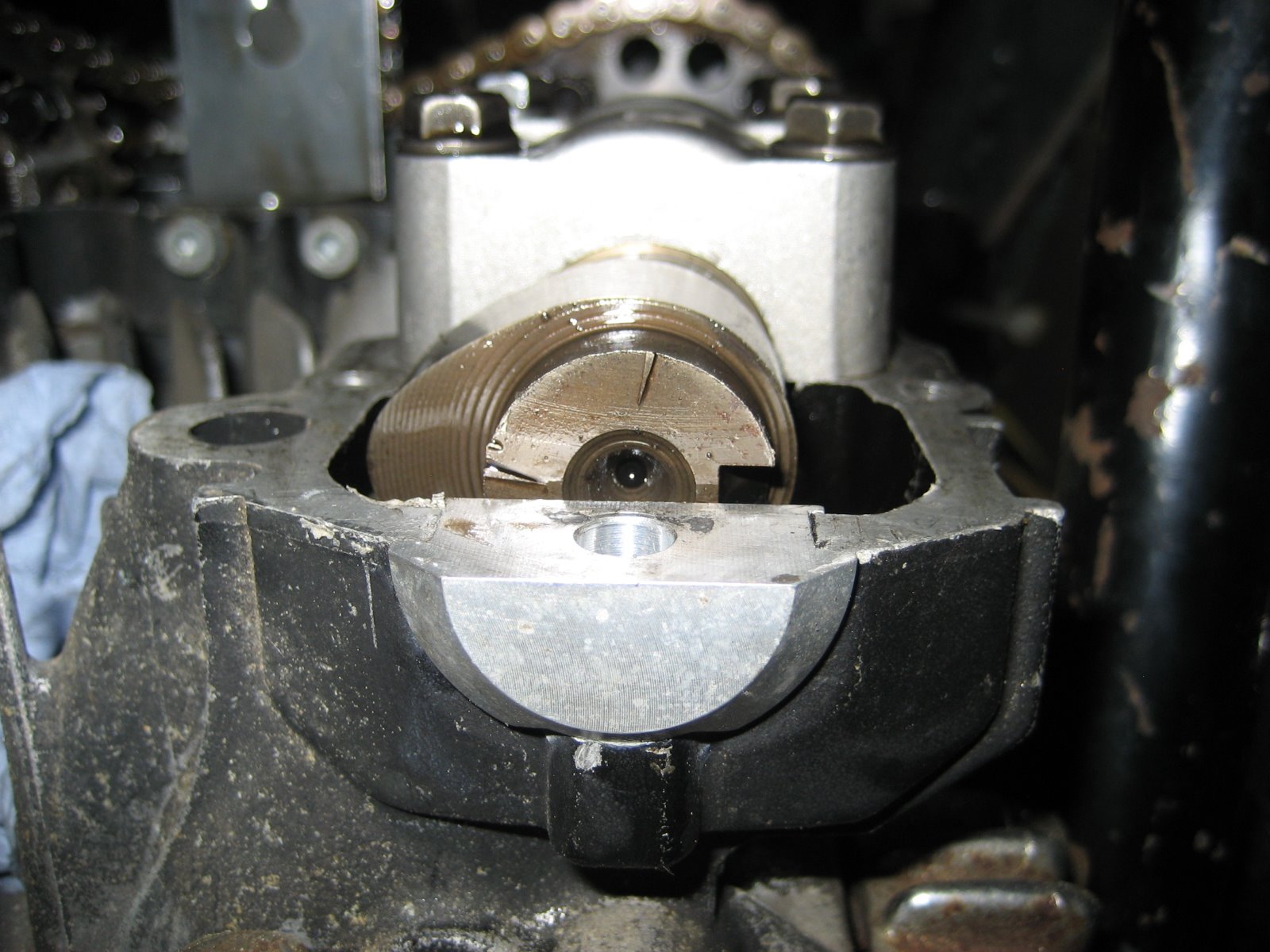

Renew the valve cover gasket and cam end plugs.
I switch to aluminum cam end plugs years ago and never had any oil leaks again.
Oil wet spark plugs are a sign of weak valve stem seals.

But I don’t see any Ape Alu end plugs for J3?
Only up to -82, will have to look around more..

Alum. plugs last sold Dec 30, 2018:
Scirocco wrote: Renew the valve cover gasket and cam end plugs.
1982 KZ1100-A2/1170 sleeper 😀

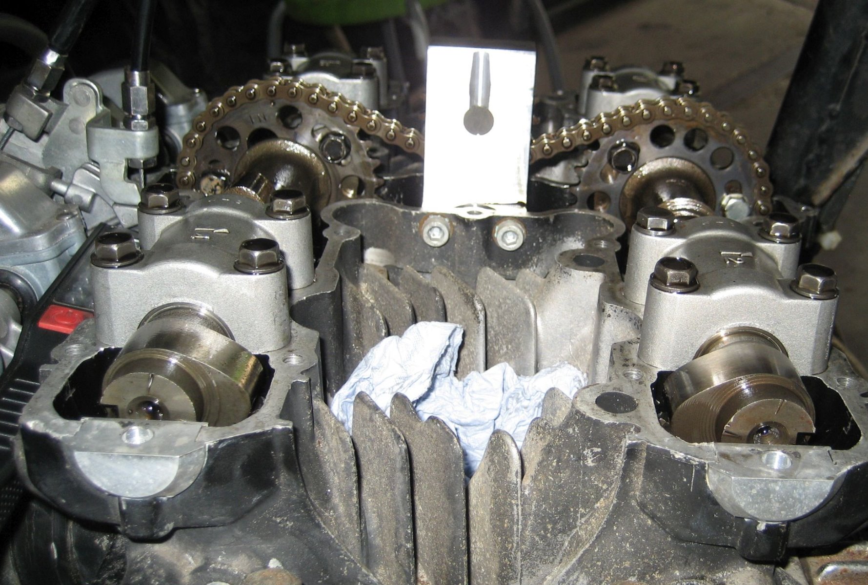

Well it turned out the valve cover only had some black silicone to seal and the cam end plugs were probably from 83,
the cams look completely new and it is on the very tight side will shim it out 0.10.
Very good surface both on cover and head after some cleaning.
Cometic gasket arrived a few days ago and 4 alu cam end plugs with bought from Germany so soon
hopefully leak is history!

So with new cam end plugs from germany and a Cometic valve cover gasket and NO silicon I bolted her down yesterday.
Cleaned up and painted the cover while at it, front left 6x52 bolt had a trashed head so replaced it with a 50mm new one.
