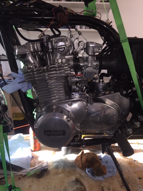

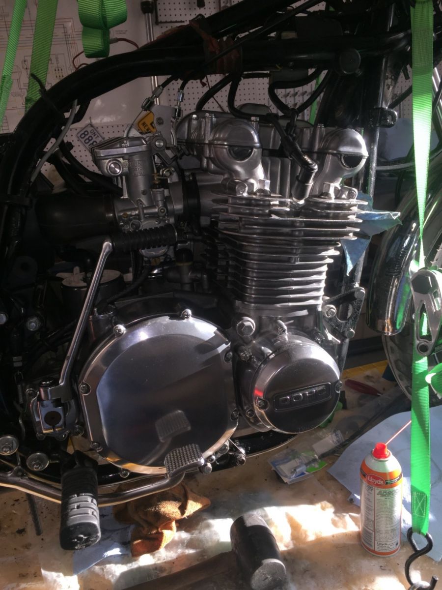

The last few days have been spent on engine maintenance. Valve clearances were adjusted. Engine oil was changed. The rest was mainly cosmetic..removed all the covers and sanded out the scratches and polished them back to new look. I don't like the high polish seen on some bikes...they never came off the showroom floor that shiny.

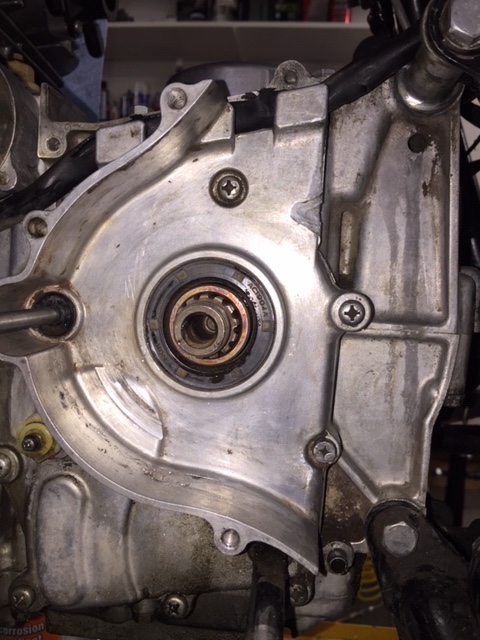

I removed the clutch cover and discovered the last time I changed the front sprocket...I put it in backwards with the shoulder outwards...doh! You can see wear marks from the chain on the tranny cover. The head on the lower screw is worn right off.

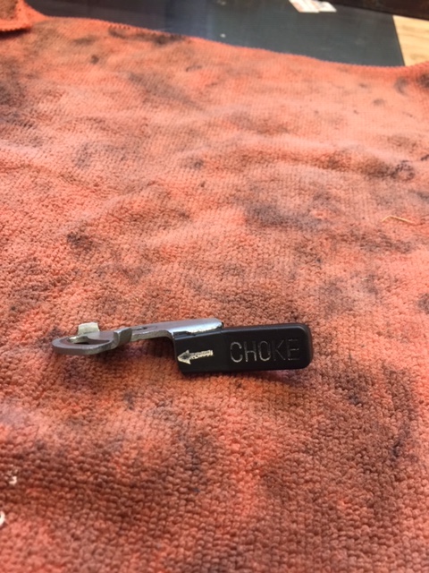

I also rebuilt the carbs using Keyster kits. They were vapour blasted and then reassembled with all new gaskets, jets, needles, etc. The synch mechanisms are unruly bestards on Z1 carbs. I far prefer the 76/77 carbs for synchronizing. Last job to be done is to re-paint the choke lever.
