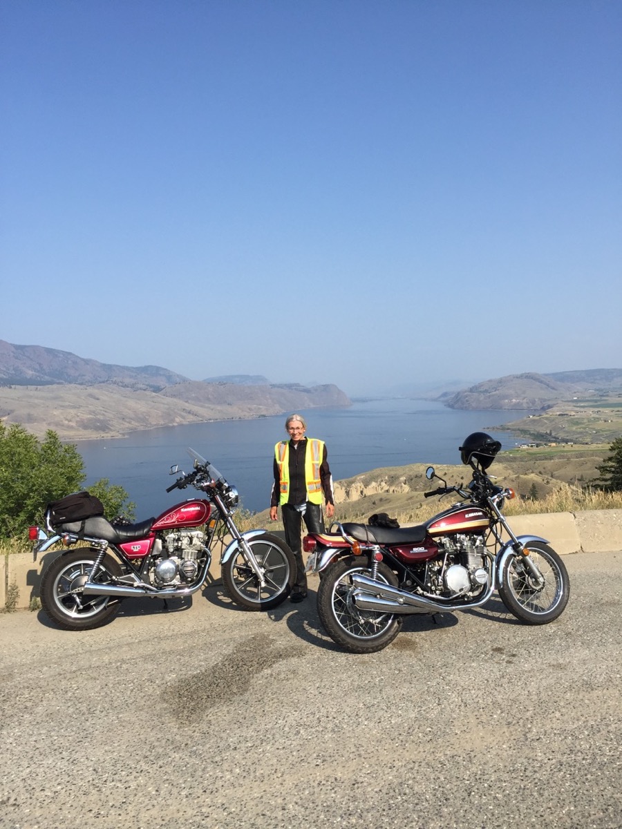

My Sweetums rides the 1981 version that we bought a couple of years ago. We replaced the exhaust with an original that we bought on eBay. Could not find anyone making OEM style exhausts. Found one 4/1 in Britain but we didn't want to go that way. Bike is under cover right now but I believe the pipes are integral to the mufflers, so you will have to replace them. Be careful if you buy off eBay as the LTD exhaust is different from the basic KZ550.
Edited to add a photo...her bike is on the left.
I understand your concern about re-jetting. The carbs are very hard to remove and remount.
