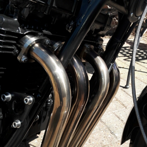

I put a Delkevic 4 into 1 on my 750/4 in 2017. The only area that gave me bother was that the black bracket which was suppoeed to hold the muffler end to the rear footrest area did not fit. Not a big deal and easy enough to cut the bracket i had and drill a new hole in it. Also a bit fiddly setting up the stop for the centre stand but all in all very happy with the system.
Be prepared to see the header area turn gold and possibly blue when you fire up the engine. Stainless steel does that. Its normal.

06 Jan 2019 01:44 - 06 Jan 2019 05:22650Dude wrote: Im happy for the exhaust to change color. I think it will look fantastic. I hope it turns blue though, not gold.
If it turns blue your carbs are running lean. It should turn bronze/gold if your carbs are set up correctly.

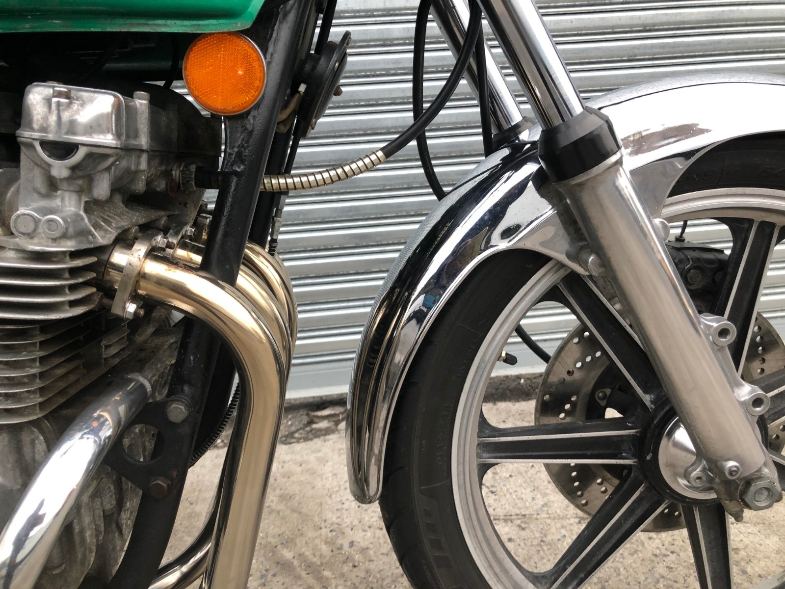

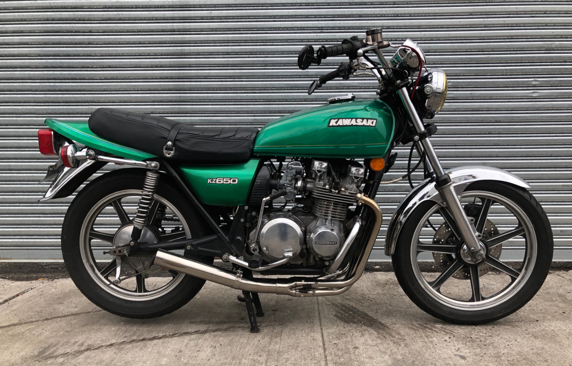

In case someone comes looking for info on a Delkevic exhaust for a KZ, Ive consolidated all the pics and info into this post.
A few weeks back I decided my stock exhaust was too quiet. I started investigating 4 into 1 options. Delkevic seemed the best of the lot, and after having a few conversations with ppl who swapped over to Delkevic, I took the plunge. The full exhaust was $325 shipped free from Delkevic. I bought it from them because I loathe 3rd parties.

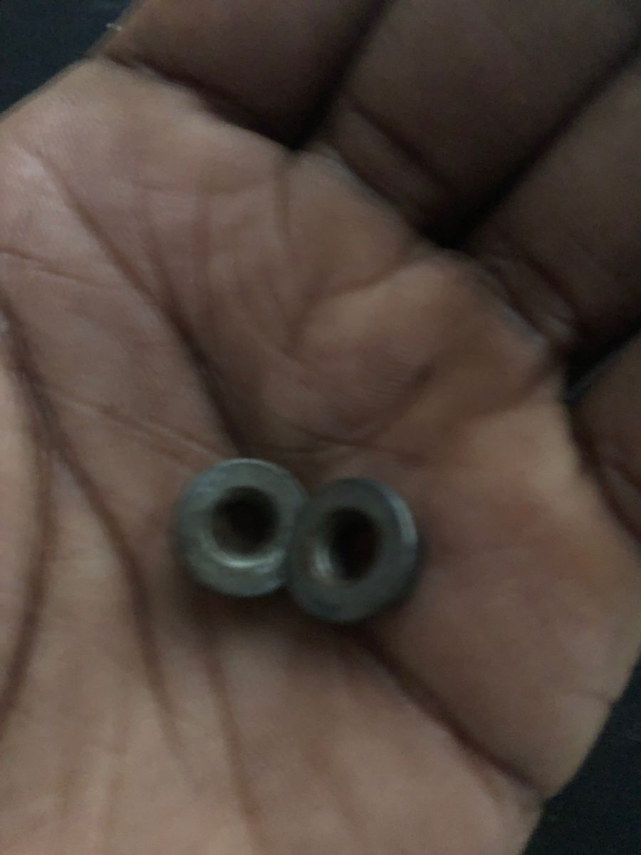

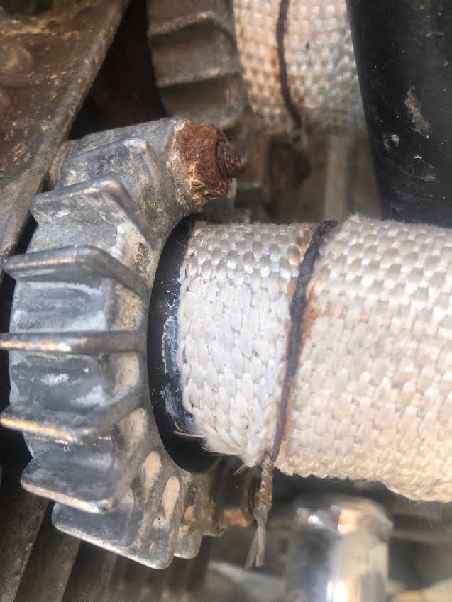

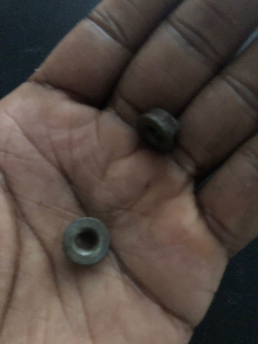

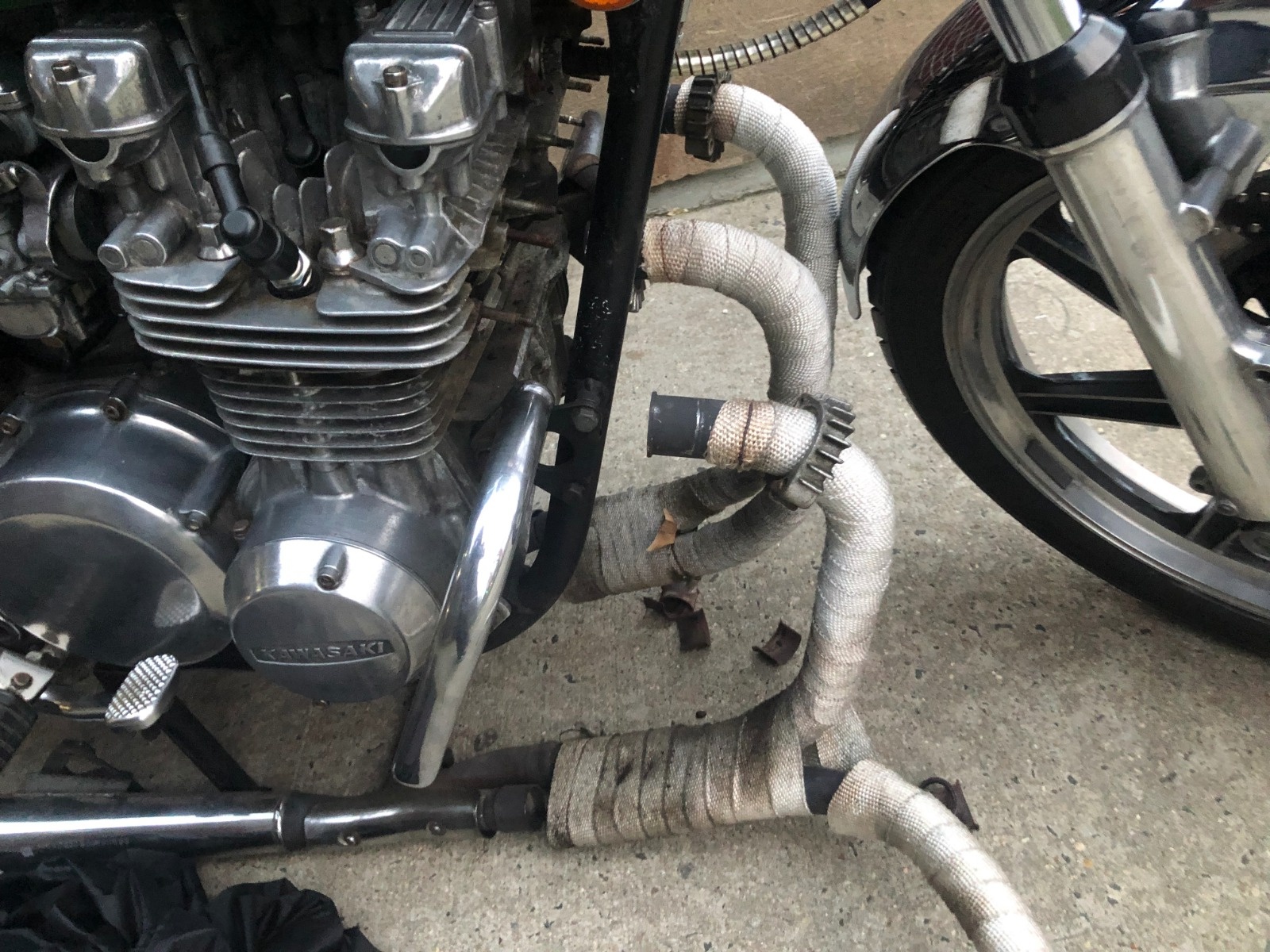

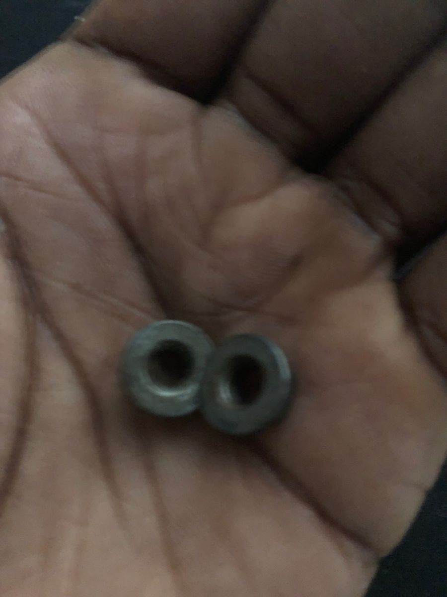

When I made the decision to get the Delkevic, I carefully looked over the stock system on my bike. The pipes (I had wrapped them a few months ago) werent rusted but the exhaust studs and bolts were. Pics below.
I sprayed WD-40 PENETRANT (not the regular wd-40) oil on the bolts. Checked back a week later and they came right off like magic.

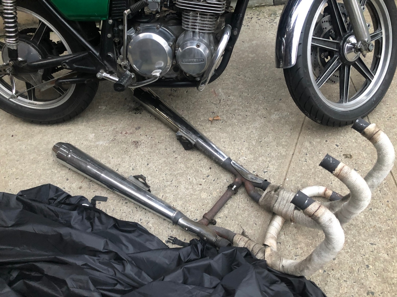

Installing the Delkevic was easy, as was removing the stock exhaust. I loosened the exhaust bolts first, then the rear footpeg bolts and voila the exhaust came right down. It was also easy to singlehandedly remove the entire stock exhaust in one piece.

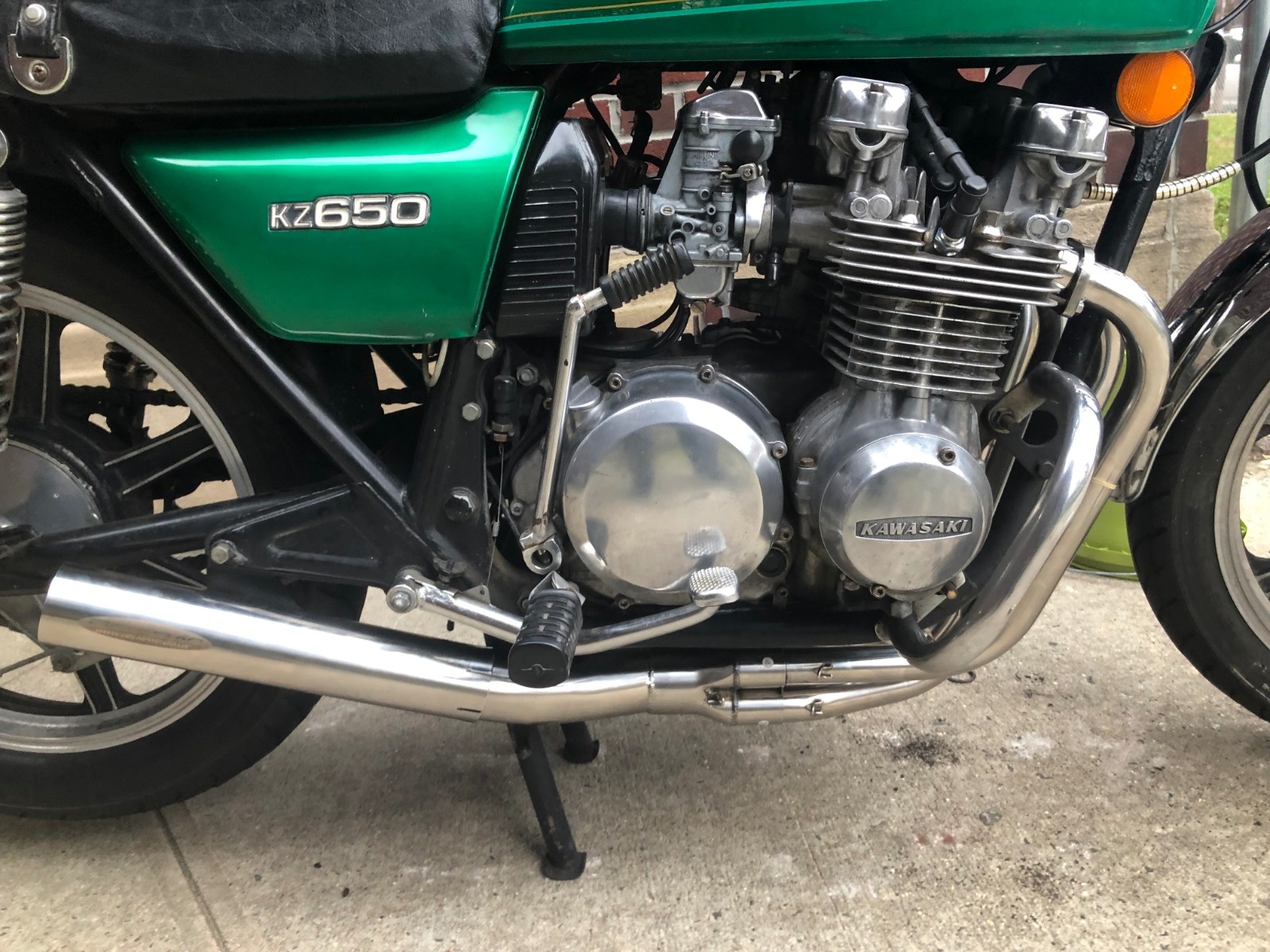

To make a long story short, Im very happy with the Delkevic system. Everything they supplied, copper exhaust crush washers, exhaust springs, rear footpeg bracket and center stop bracket, all fit perfectly.
And the sound! Omg at 7k rpms its magnificent - if you like loud, raucous exhausts
